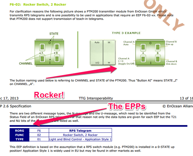

The reset and anything else does not seem to be connected.This means I can solder on wires and leave the connector for my PiFace CAD. Before I heat my soldering Iron I need to verify if things are working before I start hacking at it. My first instinct was to startup OpenHAB and see how I can interface. Turns out in the bindings, you need a device ID. Actually you need an eep or equipment profile and an id. The equipment id can be found either in the bindings documentation at https://github.com/openhab/openhab/wiki/EnOcean-Binding or in the user manual like

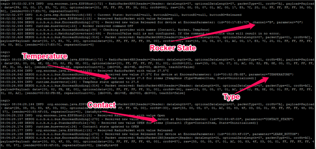

The documentation said that the device id is on the packaging. Well it was not! #fail. So I ended up installing fhem which is a perl based home automation software. The details of how to install are given at fhem.org. Now I spent about an hour just trying to figure out why it did not display the enoceans link like it is supposed to. I forgot it's a serial device and our code does not yet know which serial port it is connected to. (Face-Palm moment) You have to activate one sensor like the rocker and viola! It shows up. It now knows where the EnOcean Pi is connected to. So my rocker shows up. What about the rest? The contact can be triggered by bringing the magnet near the reed switch. It pops up too. Now you can read the device IDs and the temperature sensors as it says on the FHEM console or read the log file. The temperature sensor can work be worked the same way.
The next step is adding the bindings to OpenHAB. I followed instructions which included disabling the RPi serial console which obviously I had done already. Then I proceeded to adding the bindings as per Wiki... guess what... No go! A few minutes on google and I found this in the wiki. https://github.com/openhab/openhab/wiki/Samples-Tricks
It says to add a parameter to the openhab start.sh file. So I did and I could now see the rocker working happily. I did have to modify the examples a bit.

Switch Rocker      "Rocker" <switch> (All) {enocean="{id=00:17:E5:7C, eep=F6:02:01, channel=B}"}

According to the documentation for the temperature sensor, there is a WAKE0 pin which has a jumper connecting it to a pull-up voltage. You can manually wake it up by connecting to a ground pin. Now theses pins are really small but I managed to trigger it by carefully connecting it once. It transmits the temperature and the console screen shot is as follows.

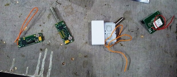

    Sounds like valuable input, looking forward to your desoldering adventures image
  • ipv1
    ipv1 over 12 years ago in reply to fvan
    Thanks for the input.
