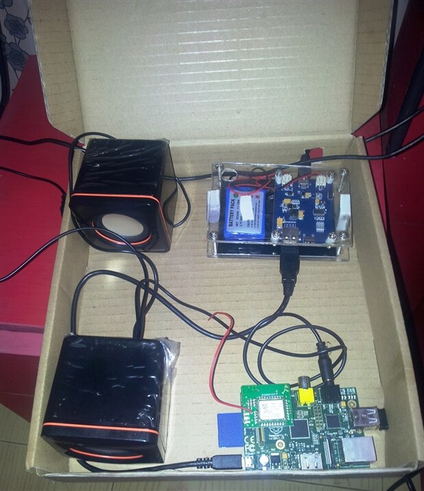

The EnOcean Sensors are Energy harvesting modules. This means that they don't need (standard) batteries. They either have a solar panel or some other way of generating the required amount of energy. I won't go into the details but I personally think it's brilliant. Each sensor is able to transmit it's data such as contact, switch or temperature data by default and they all talk to a "Mother Node" called the EnOcean Pi. You can buy sensors individually as well as the EnOcean Pi module which you can mount onto your application board. The output of the EnOcean Pi is a Serial(UART) data stream when events occur. To my understanding the EnOcean Pi listens to the wireless transmissions from sensors and if a VALID message is heard, it generates a message in a predefined format on a wired serial bus at a fixed baud rate. Hence the EnOcean Pi essentially validates wireless data and then funnels all the wireless data to a single two wire serial bus.
To my understanding the EnOcean Pi has just 4 pins which connect to the Raspberry Pi. They are the 3.3V, GND , UART TX and UART RX. I will be doing some experiments to verify the same very soon. I have not seen any reference for commands to be issued to the EnOcean Pi hence I assume it is not a programmable device. OpenHAB needs to essentially listen to the UART and parse messages to the Event Bus. That is what the bindings do... I think. The next section will document how to interface OpenHAB with the EnOcean Pi and Sensors.

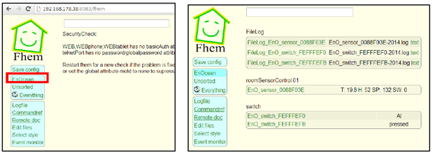

FHEM is a perl based Home Automation Solution like OpenHAB but OpenHAB is way cooler  . We need FHEM to get the device IDs because EnOcean does not print them on every device. FHEM can be installed by executing the following commands at the command prompt.
sudo apt-get install perl libdevice-serialport-perl libio-socket-ssl-perl libwww-perl
sudo apt-get install –f
wget http://fhem.de/fhem-5.5.deb
sudo dpkg –i fhem-5.5.deb
Now reboot. Once the system reboots, FHEM is automatically started. Point your favorite browser to http://raspberrypi:8083/fhem The screenshot below is what you should see.
(image from attached doc FHEM install)
Don't see the EnOcean link yet? Don't worry. Trigger one of the sensors liek the contact switch or the rocker. This will cause the EnOcean Pi to send a message over the uart which will make the FHEM system recognize your EnOcean Pi. Click on the EnOcean link and you should see the Sensors and their IDs. Great. In case you don't see anything, make sure your sensors are charged. The rocker works the best.
Now you have the IDs for YOUR PARTICULAR sensors. Next the EEPs. I'll make it simple. The profiles are as follows:
  • Rocker: F6:02:01 (Light and Blind Control - Application Style 1)
  • Contact sensor:D5:00:01 (Single Input Contact)
  • Temperature sensor: A5:02:05 (Temperature Range from 0° to 40°)
At this point FHEM will always start at startup and will lock the serial port. You can uninstall it OR disable autostartup by issuing the following command.
sudo update-rc.d fhem disable
