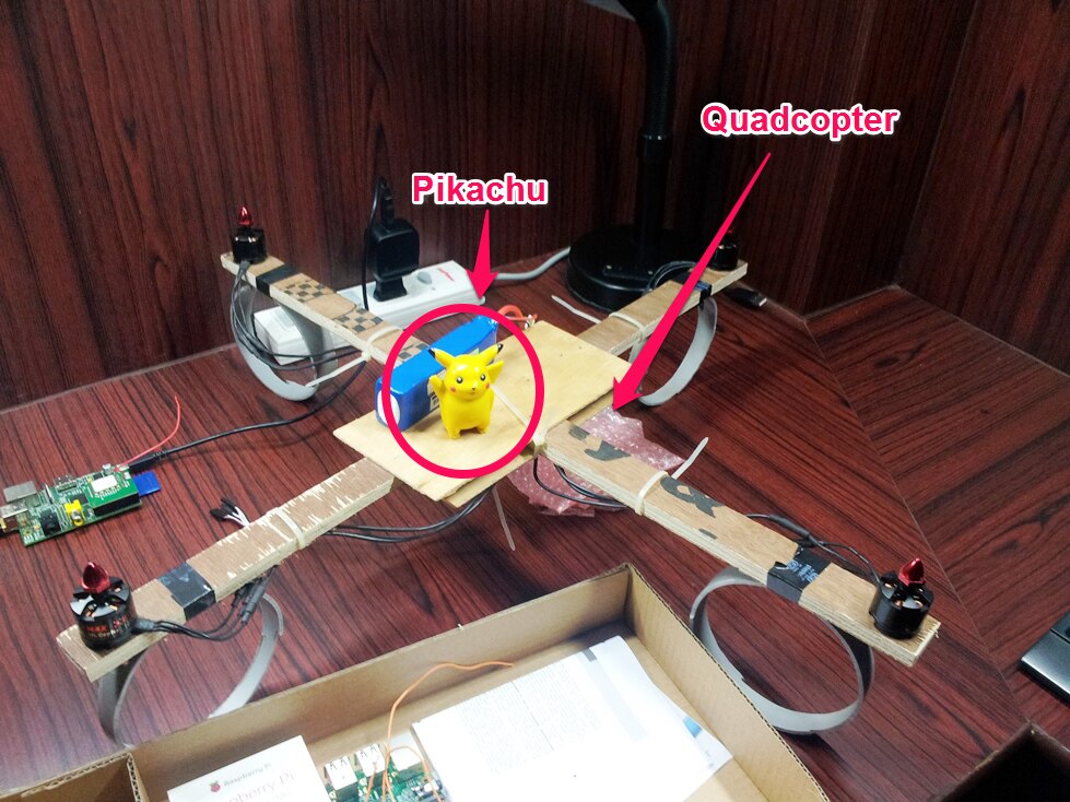

My quadcopter was supposed to take first flight this weekend but since it is now a 'minion battle royale', I thought I would kick it up a notch. Batman was abducted from my workbench and now Pikachu is sitting there alone. I thought Minion Dave would make an excellent addition and hence I am doing this post today instead of tomorrow morning in the hopes that I get a friend for poor pikachu.

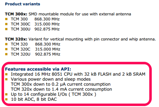

The EnOcean TCM320 Anatomy
It is important to understand what makes the enocean modules tick. At the heart is an 8051 uC which has quite a simple architecture. I teach a course on it and I have used it in Industry products successfully. The 8051 core is modified to work with low voltages and to have a deep sleep mode which allows it to consume almost no power. TI's MSP430 is usually where I go to get ULP uC but this seems to get the job done as well. The datasheet is available at the EnOcean web site and will prolly update with time. The interesting bit is this part below.

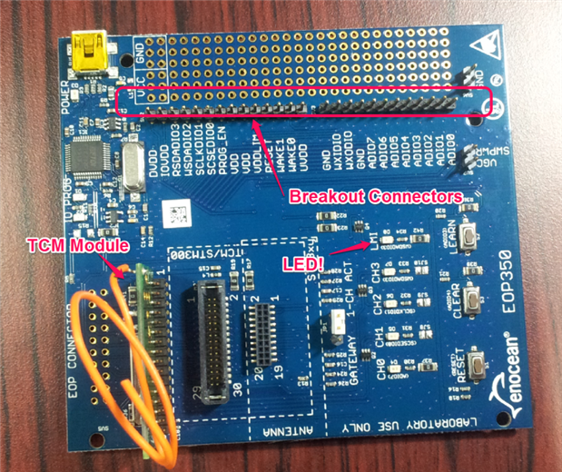

This means I can use the ADC to read a value and transmit it to no less than the EnOcean PI and to OpenHAB. EnOcean makes this quite easy by not only giving us the EOP350 but the API and Dolphin Studio and Dolphin View for download at their website. I am going to try and get the LED to blink first and then work up to the Sensing. The EOP350 can be used to do experiments since it has a general purpose area as well as the PINs from the modules brought out! Fantastic! Here is the break up.

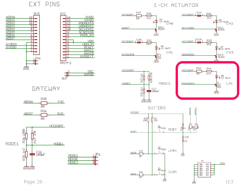

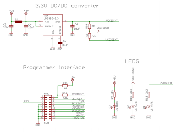

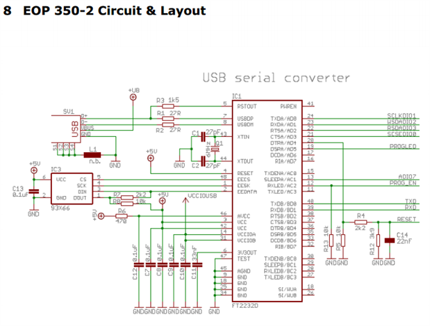

The next step is to find out where the LEDs on the EOP 350 connect. For that the datasheet is available at the website as well. The schematic part is what I am interested in.
Datasheet Exploration

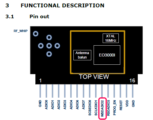

So I downloaded the datasheet from the EnOcean WebSite and...
Now this means that the WSDADIO2 is connected to LMI LED and I can try and program it to blink. This is enough information and now we can start with the software.

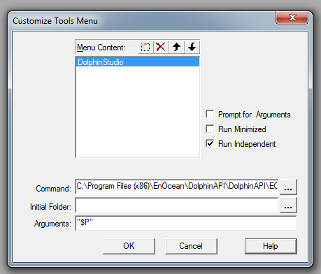

We need to connect the Dolphin Studio which will be used to generate configuration code with the Keil COmpiler which will be used to compile the firmware. In the install directory for the Dolphin API, there is an examples folder which as some ready code with uvision projects.
You need to create a new menu by...

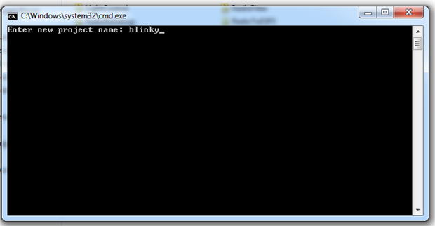

Creating a Project

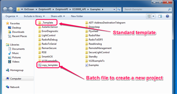

Creating a project is very simple. In the Examples folder where you installed the API, there is a file called Copy_Template. Execute it and you can create a new demo project.
IMPORTANT: I usually install this stuff in a drive other than C: since windows UAC will cause problems. I recommend this for win7 and above. Also run the Copy_template.cmd as administrator.

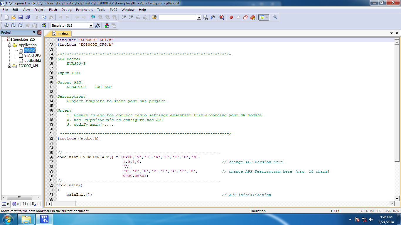

Now open the Keil project. This is what you should get...

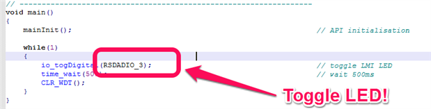

Now I did not choose the LMI LED randomly. The template already has code to toggle the LED.

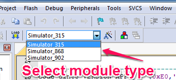

Fantastic! Next Select the Correct module type. This makes the decision for which files are to be included and which included in the build process.

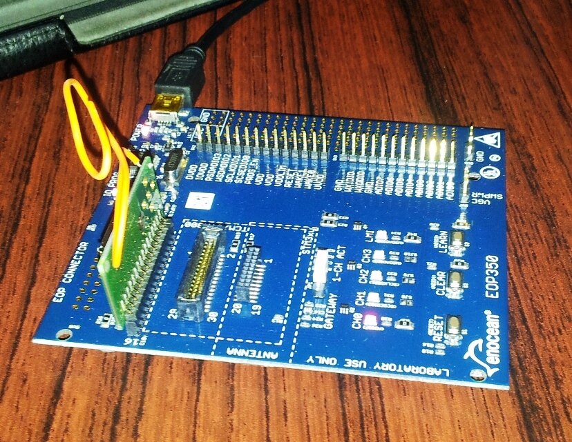

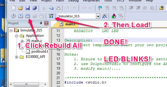

The last step is to connect the EOP350 and the TCM module.
First Click Rebuild all and then the Load button. It will invoke the EOP350 programmer automatically! Fantastic. Now you have a blinking LED.

    ipv1 over 12 years ago in reply to mcb1 +1
    That's four emax 935kv motors and 1045 props. I did the math... It should fly
    mcb1 over 12 years ago in reply to ipv1 +1
    I did the math... It should fly I've seen a few TV programs that said similar things .... Luckily yours is simply a " fail to take-off or poor performance ". Besides all the feature s that "Dave" has…

    If you install the EnOcean API Modules BEFORE you install keil then you will have to add the items manually. I suggest running the EnOcean Installer AFTER Keil has been installed.
    Lemme know if this works for you,.
