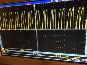

Hello, this week I did a lot of testing and debugging with the oscilloscope. I try to see and solve the problem of my network of temperature 1-wire sensor.
I try first to change my connection to the 5v and 3.3v use, I also change the cable connection together. Using the 5v is really not advise for raspberry pi but its still work reasonably well for 6 months.
Result : failure no captor are detected
Then I tried to change the way power sensors using the parasitic mode. As some suggest me in another post
Result : no difference, no captor detected
Here are some screenshots of what I normally should have as working signal
With 1 sensor on 3.3v
With 1 sensor on 5v and level switcher
According to this guide Guidelines for Reliable Long Line 1-Wire Networks - Tutorial - Maxim my curve have slow rise time and maybe some reflected problem

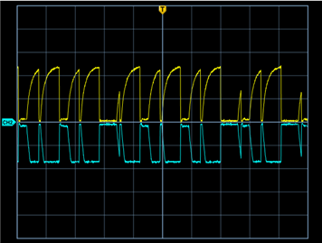

Finally I retest on 5v but with a level converter https://www.adafruit.com/products/757 to send only 3v on raspberrypi port
Result : Success all captor are detected and all communicated data are correct
Interesting curve. Yellow is the 5v side data and Blue the converted 3.3v result

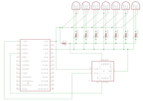

I'll do other tests removing resistors supposed to improve communications and see if it really helps and I will also make a soldering version on a perma-proto board.

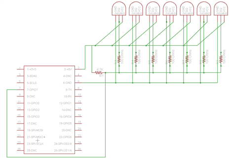

Do you see anything else that could improve my circuit?
Old schematic
New improve schematic
    mcb1 over 12 years ago in reply to verrverr
    The spec talks about a nominal 5k pullup, and goes further to show a stronger pullup for long conversion times (12bit).
    The sensor needs to be able to pull down the line, and perhaps some of the other one wire devices are not capable.
    It almost seems that one of your sensors is drawing too much current, since the rise time is still rounded even at 1.5k.

    Hi i just do some other test with lower pull-up resistance. And really works better. With 2.7K or 1.5K i can use 3.3v directly without level converter.
    The spec indicates use 4.7K resistance, is that the use of a 1.5K or lower can break sensor?
    What is the best use of 4.7K ressitance on the 5v to with level converter to 3.3v or use 3.3V with 1.5k or lower ressitance

    Managed to measure from my network built with DS9490R, uses 5 DS18B20's (all in parasite mode), couple of AD-converters etc. Cabling is done with random cables found on my desk, ranging from 0.25 mm² to 1.5 mm². The whole network includes about 30 meters of cable.
    As you can see from the captures, the active pull-ups work miracles. I'll try and measure the same network with the DS2482 I suggested earlier, although I'm sure the results should be quite similar...
    Also, I forgot to mention before, applies only to parasite power: I had problems before, when I was trying to read the data too frequently. The pull-up didn't have time to charge the internal capacitors of the sensors and this caused the measurements to fail.
