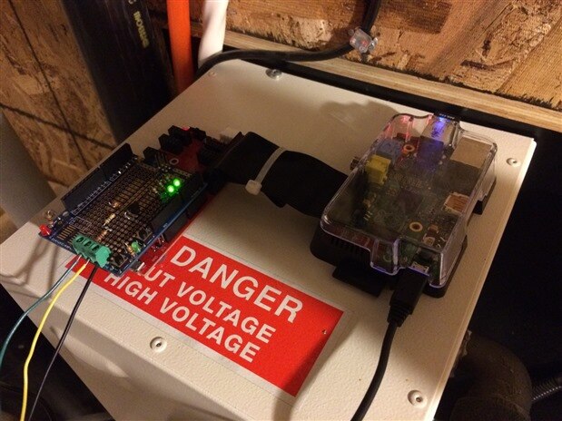

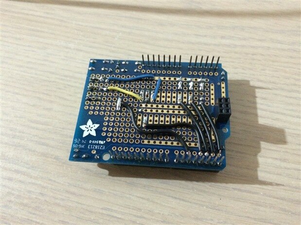

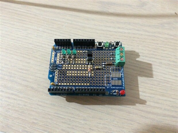

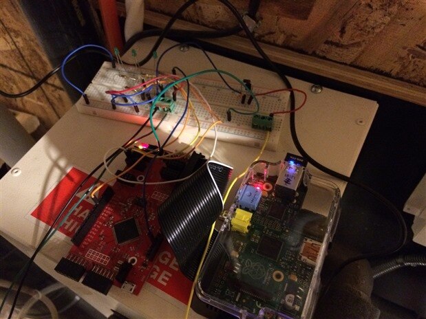

From Proto board to ProtoShield
Last week i made a more final version of my home ventilation proto.

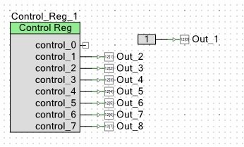

I use an arduino proto shield https://www.adafruit.com/products/2077 directly on the RPiSoC but with minor modif to the RPiSoC software because the shield cause RPiSoC reset loop. On the shield the ICSP Reset pin and Reset Pin beside 3.3v pin are connected an cause RPiSoC reset. Robert Barron from embedit electronics send me a working fix for this trouble.
As for the reset situation I think I have found you a software solution. However, we have used multiple Arduino shields that have reset buttons and ICSP headers without issue, so I'm not sure why this one caused an issue. I will look a little further into it to see if we should change anything on our board.

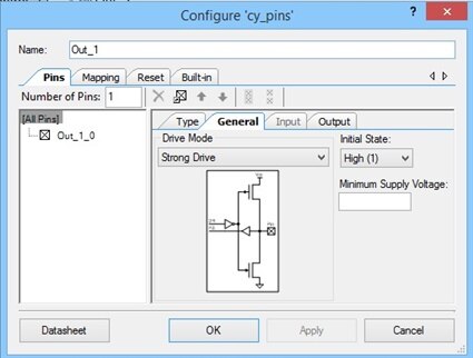

Either way here are the steps that will hopefully resolve your issue:

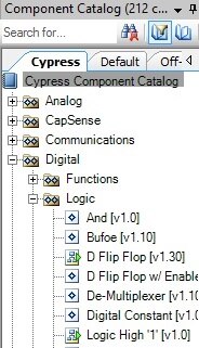

1. Open up the psoc_2_pi psoc creator project.
2. In the top design file (the schematic view) go to page 3.
3. Disconnect the pin labeled "Out_1" from the control register. You can do this by clicking the green wire that connects them, and then hitting delete.
4. Attach a "Logic High '1'" component to the "Out_1" pin. You can find the component on the right pane under the Cypress tab, then Digital -> Logic -> Logic High '1'
5. Right-click the "Out_1" pin and then click on Configure.
6. Click on the General tab in the middle. Set the Initial State setting to "High(1)" if it isn't already set to that.
7. Rebuild the project and then reprogram the RPiSoC with it.
This should stop the reset loop from occurring. This pin controls the LED. If you want to use it you might be able to get away with only setting the initial state high without disconnecting it from the control register. I have attached pictures that should help guide you through making these changes. Let me know how this goes.

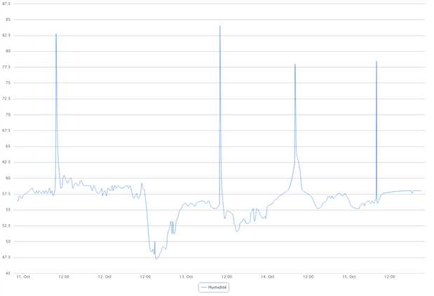

And i and one simple rule to detect fast  humidity increase. On the above picture you can easy see when i take my shower. To detect the humidity fast increase i just calculate the Slope from the two last humidity point and if is bigger than a treshold i start the vent. Slope - Wikipedia, the free encyclopedia
This is my OpenHab rule (https://github.com/pascalmartin/ForgetMeNot/blob/master/bundles/openhab/openhab/configurations/rules/default.rules)

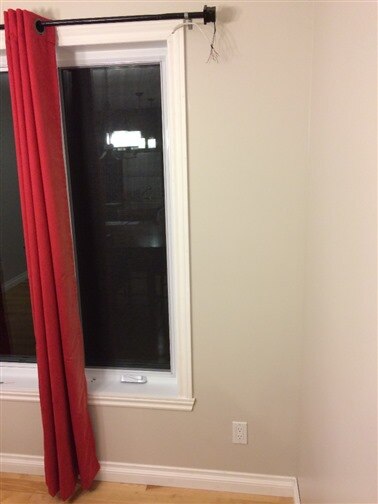

Curtain progress

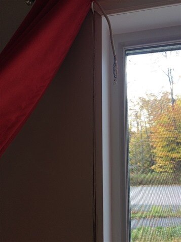

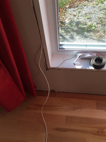

I do some progress with my proto, i think It is relatively reliable now, see this 2 demo video

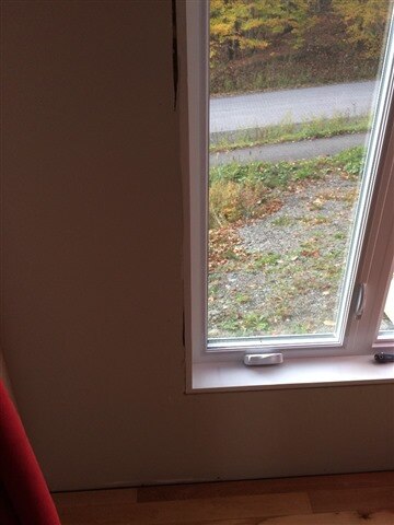

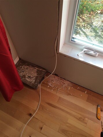

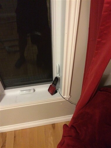

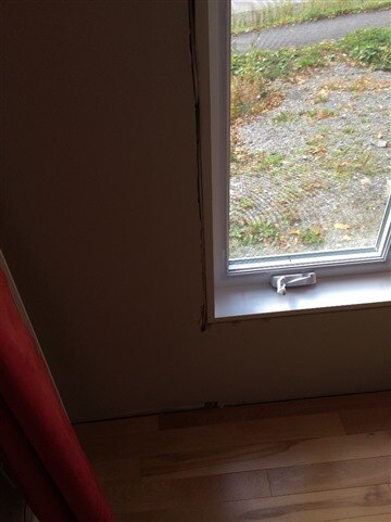

Now i will finalyse the remote control with openhab and the connection. Last weekend i do the big job of passing the cable in the wall for my 3 windows  on the ground floor.
The result is great, I'll just have to do a little touch up paint because it has a nail that reissue the wall (Near the phone in the picture)
