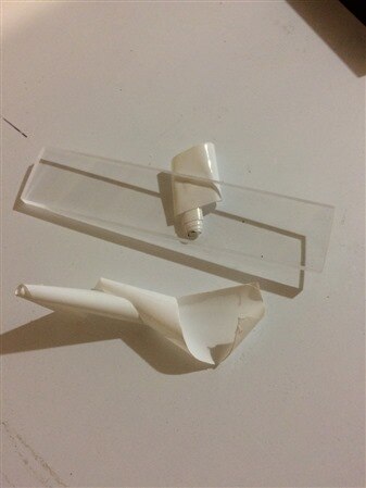

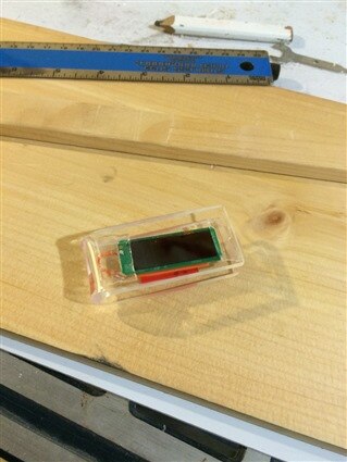

Here are the most detailed instruction to manufacture of a very simple braket for the temperature sensor

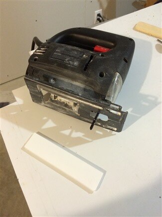

Step 1

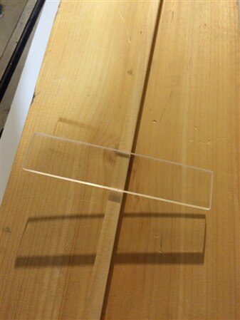

Cute 4.5mm acrylic clear board with a Jigsaw to made a rectangle of 3cm x 13cm

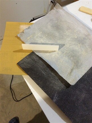

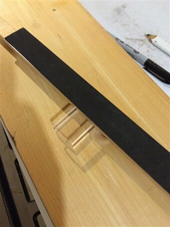

Step 2

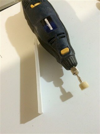

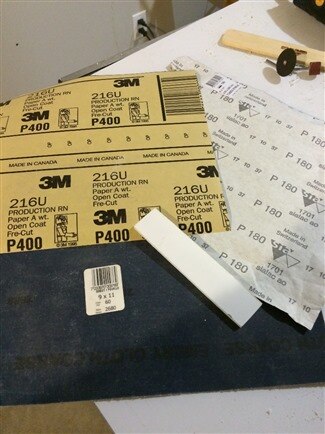

Sand the side of the cutted restangle for good finish, i use sand paper of 60/180/400 and i finish with cutting weel with a small polish brush

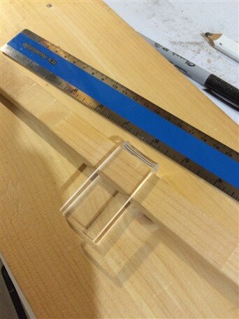

Step 3

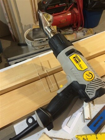

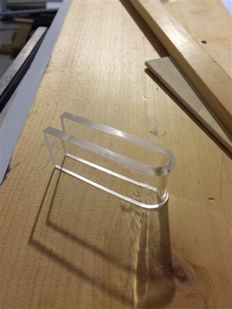

Remove the protection paper and bend the plastique using a hoot air gun. I use a small piece of wood with the proper thickness for the sensor 9mm. Use other piece of wood or an metal ruler when the plastique is hot enough to bend and keep the plastique in the good position

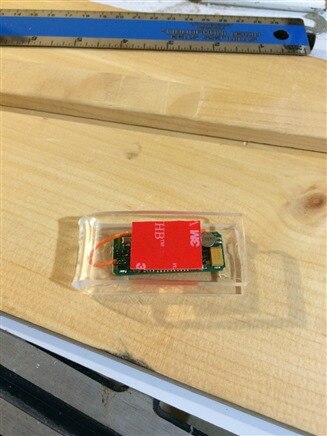

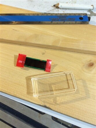

Step 4

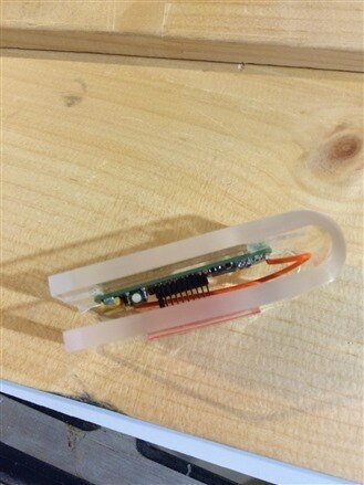

Wait until the piece cools and place the sensor in with 2 side tape.
Step 5
Put an other 2 side tape under the case and stick on the wall at the desired location
