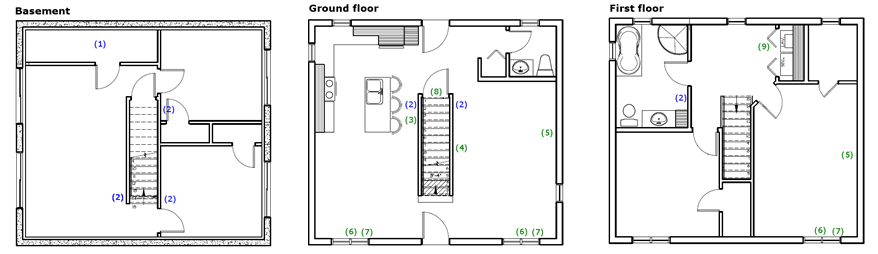

The nagging questions that I will try to answer with my project are:
  • Did I leave the curtain open or close?
  • Did I leave the washing machine active or not?
  • Did I leave the basement door open or close?
  • What are the temps near my windows?
The Plan in picture
The Plan in detail

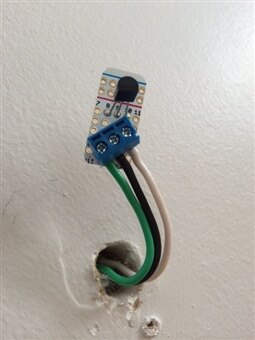

(1) Incorporate EnOcean temp sensor data in existing application

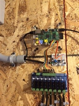

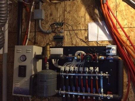

My current head controler system use temp DS18B20+ sensor (2) and sainsmart Solid State Relay Module for control my house water heat system.
Current application use postgresql databse for save sensor data and nodejs server for host webserver.
We need to add support for 3 new EnOcean temp sensor (6)

(3) Build new control panel
With an Raspberry Pi and Adafruit PiTFT we made control pannel with the capacity to see and control home temps and control curtain open/close

(6) Add EnOcean temperature sensor
Add 2 or 3 EnOcean temperature sensor very near the window and display sensor data in my existing system.
Use temp of captor near the window and other temp sensor in room for automatically open or close curtain.

My existing system
