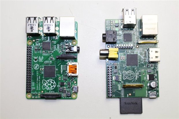

Figure 1. A Model B+ next to a Model B.
There are some subtle changes including the repositioning of some connectors, the replacement of linear power supplies with switch mode types, the replacement of the SD connector with a microSD connector, the removal of the RCA video connector and associated components, a larger expansion port and some usable mounting screw holes.

    I was not aware that the B+ was a complete redesign of the board layout.
    The larger GPIO connector is a definite plus and I really like the addition of mounting holes.
