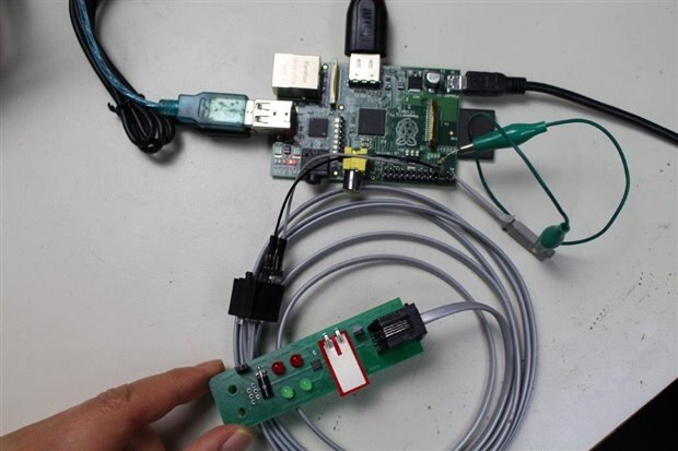

Pictured is a 19 year old Dallas 1-Wire Demonstration and Development Kit PCB connected to my Model B Raspberry Pi.
That's right!. The 1-Wire Interface is nearly if not 20 years old. The 4/8bit parallel interfaced LCD Character modules are older at about 30 years. The DS1820 Thermometer is the component that is closest to my fingers. The other 1-Wire devices are GPIO devices. One connected to a piezo sensor to detect movement and the other to drive LEDs.
Adding a thermometer IC to a Raspberry Pi can be a very simple affair. One of the main features of Dalla's (Now a part of Maxim) 1-Wire Interface is that their devices can operate from parasitic power hence reducing the interface to one wire (plus a ground reference). Maxim have a range of iButtons that present only two contacts to prove my point.
Dynamic 1-Wire device insertion and removal testing shows that the current driver only supports the detection and insertion of new devices but not the deletion of removed devices from the /sys/bus/w1/device directory.
Interestingly a VDD between 2.8-5.5V is recommended to enable I/O functions for the DS2812 but a lower minimum voltage of 4.3V is required for +/- 0.5 degree Temperature conversions. This explains why VDD is connected to a voltage source rather than being tied to GND and relying upon parasitic power.
My testing shows that if you don't then you get correct device responses but useless thermometer readings.
