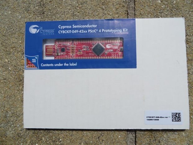

I'd like to thank Cypress SemiConductor for sending me out two new CY8CKIT-049 PSoC4200 Prototyping kits. They arrived in quite novel packaging.
I was privileged enough to receive an engineering prototype earlier and was going to use it for this challenge but was provided the released versions to showcase them.
