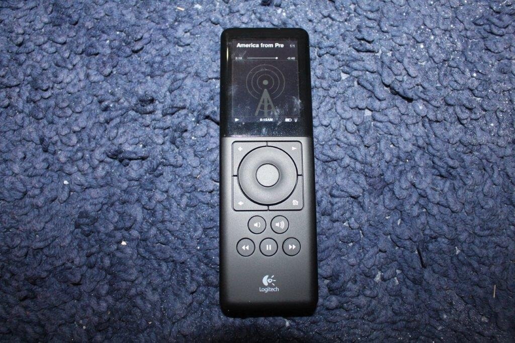

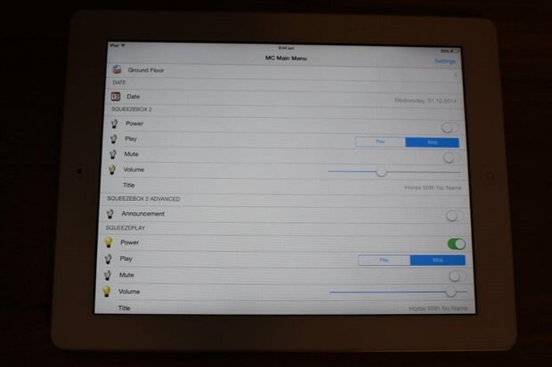

Figure 1. A WiFi SqueezePlay under iPAD openHAB control
I seem to be working backwards. I built up a Raspberry Pi Model B+ with a NOOBs SD Card and installed OpenHAB 1.5.1 with root privileges using sudo.
This seems to work considerably better than my first attempt where I was experiencing very slow performance and frequent lockups.
One of my goals was to get Squeezebox peripherals working and I have done just that. I have successfully got a SqueezePlay and Squeezebox Boom working.
I am able to select and play songs from my media collection, turn the units on and off, mute and demute, control the volume, play and stop.

The presentation interface of openHAB on Internet Explorer 11 and Firefox on my PCs is dire. Elements do not appear to align correctly giving it a amateurish look. However when operating from my iPad using the openHAB app things look much more professional.
The interface works both ways, in addition to controlling the Squeezeboxes you can display their current status.
