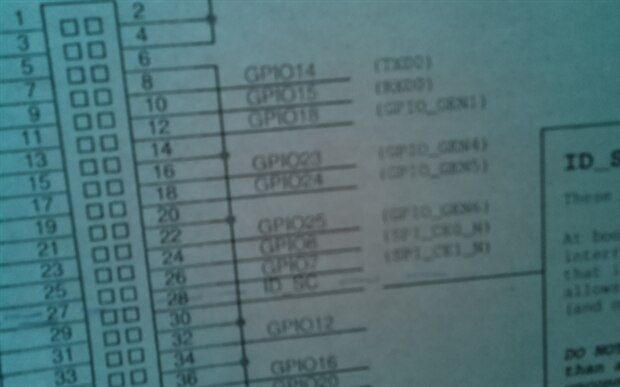

Figure 1. - A test picture taken by Rpi with OpenHAB when pressing a door bell.
