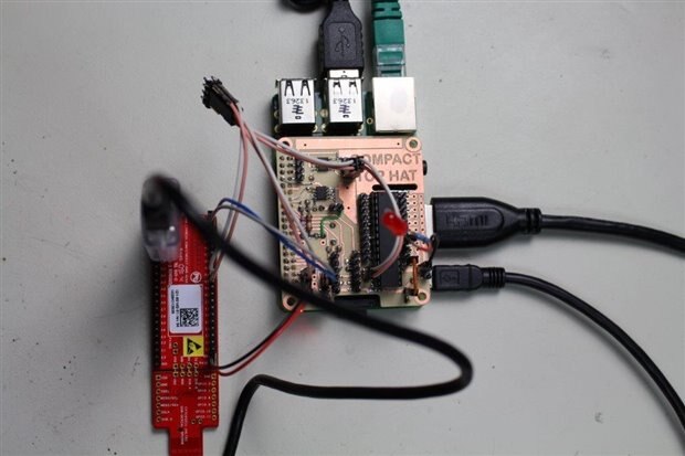

Figure 1. Initial PSoC4 tests using a CY8CKIT-049 4200 with the Compact TOP HAT with concurrent UART and I2C interfaces active.
(The blurry lead is a MiniProg3 used for single step debugging.)
My Compact HAT enables a PSoC to be easily connected.
The design has a PSoC connected to the Raspberry Pi's Serial Port, I2C, SPI port and some GPIOs.
The intention is to have;
  • SPI port as an interface option
  • I2C port as an interface option
  • Serial Port as an interface option or a program load interface for the PSoC
  • GPIOs as interrupt and auxillary inputs or outputs between the Raspberry Pi from the PSoC
  • The remaining PSoC pins remain free for the user's design
These are native interfaces with the Raspian and require very little configuration.
Although possible I did not consider using a parallel interface to the RPi because I did not have an immediate need for it and it required some LKM (Loadable kernel modules) written for it..
I could have laid out the prototype to include a PSOC but that would have tied me down to a single option. Instead I provided ordered connection points to provide more flexibility and choice such as using a PSoC5LP.
The CY8CKIT-049 42xx provides very easy access to its PSoC pins making it perfect for prototype development without the hassle of hand soldering TQFPs. It also allows a direct plug in connection for a MiniProg3 or other PSoC debugger.
