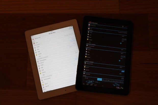

openHAB & Eclipse SmartHome
Figure : My OpenHAB Controllers (Wireless and fancy free!)
I had never heard of let alone used OpenHAB prior to this Road Test Design Challenge. I was initially confused as to the difference between Eclipse SmartHome and OpenHAB as these terms were used interchangeably.  I searched the net and found this link that fully explains it. http://kaikreuzer.blogspot.com.au/2014/06/openhab-20-and-eclipse-smarthome.html
After installing, using and coming to grips with OpenHAB 1.0 – I found it to be remarkably easy to use and configure. All one needs to know is how to configure the main elements to produce a system to suit one’s needs.

One great feature of OpenHAB is that there’s no need to design web pages to access your OpenHAB system. There’s an OpenHAB app available for both IOS and android devices to give you access to your OpenHAB system. Alternatively a Web browser can be used. These GUIs are defined by the Sitemap configuration files.  These are easy to configure text files representing the organisation and displayable items for the GUI. This user interface is consistent across all device options.

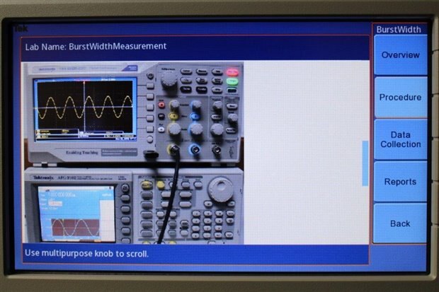

TEKTRONIX SCOPE
Figure: The mighty TBS1052B-EDU's display showing off it's fantastic quality!
Tektronix TBS1052B-EDU Oscilloscope – This is a truly great piece of entry level kit. It is remarkable how Tektronix have improved their test equipment and yet retain the same price point. This instrument boasts a high resolution rich colour display and makes waveforms appear very clearly. Unlike some other Oscilloscopes is operation is silent as I could not hear any annoying fan noise.
Its controls are very easy to use and the incorporation of a push button into the Multipurpose dial makes it even easier to use. You can now select the desired item by highlighting the option you want with the dial and pressing the dial down to select it. The front panel has convenient colour coding to associate the front panel controls with their associated channel.
The USB interfaces make it very easy to transfer screenshots and captured data to a PC workstation or printer and to upgrade its firmware. With the supporting PC software installed a screen capture is a simple as a click of a button.
The Maths functions are ever so handy. With them you can see the accuracy of sine waves with the FFT display function or with the Add functions check the net result of a differential signal for unwanted artefacts.

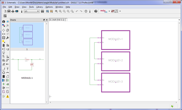

CADSOFT EAGLE
Figure: Hierarchical Schematic demonstration in action!
CADSoft EAGLE is a great Schematic Capture and PCB Layout program. It is highly configurable and in addition to just producing Schematic Diagrams and PCBs it also can be used to create accompanying SMD stencils. With Version 7 it now has hierarchical schematic diagrams. This feature is used to clearly articulate complex designs with sub assembly or multiple sub circuits. I produced a video to demonstrate this feature. The hierarchical schematic function requires a suitable EAGLE license. One that allows the use of multiple schematic sheets such as the Free Trial (Freemium), Hobbyist, Standard and the Pro license supplied for this challenge.

I have set up an impressive OpenHAB system that is ever evolving. It’s fully operational where I have many IoT devices that are accessible from Wireless Android and iPAD tablets. I can turn devices on and off, monitor sensors and display images captured from Network Attached cameras. It even sends alert emails (some with images) as necessary.
This system first started off as a standard run of the mill OpenHAB demonstration system.  From this I developed my own system by creating my own custom sitemap to have my own GUI control panel.

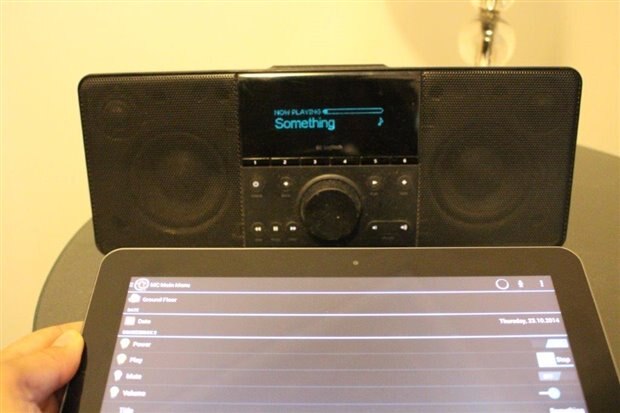

To this I interfaced my SqueezeBox Media Player system.  This consisted of downloading and copying the Squeezebox bindings into the addons directory, configuring squeezebox binding parameters in the configuration file and adding items to my own sitemap. I can now turn my squeezeboxes on and off, adjust its volume, mute and select the music track played.

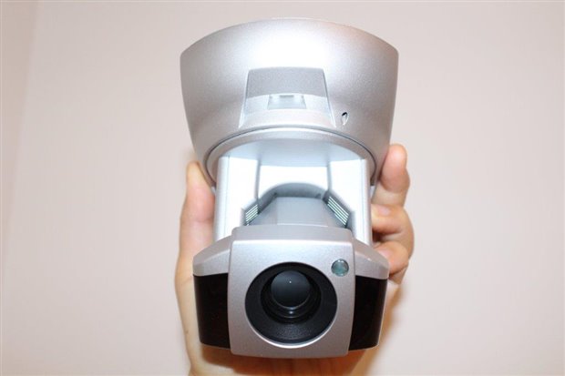

I interfaced a COMPRO IP-750 PTZ network camera. It can be controlled using an HTTP interface so the http bindings were copied into the addons directory, added camera control and display items to my own sitemap. I can now pan, tilt zoom and perform snapshots on the camera from my OpenHAB control panel.
Figure: Compro PTZ Network Camera
