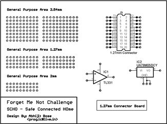

I have designed an PCB holder for the EnOcean Sensors. This PCB would help to mount the sensors on the doors, windows and other desired locations.
Thanks to EnOcean for the Additional PTM200C module, Rockers cases , STM320C enclosure and the connectors.
Actually I missed to order the 1.27mm pitch connectors, so EnOcean sent me a couple of spare 1.27mm connectors.
They also sent me a small enclosure for the STM320C this helped me to design this PCB and fit the first sensor on my door.
Thanks a lot to EnOcean and Element 14 for extending support.
The PCB has been shipped, I will post an update one I receive them. In the mean time if any one else want this PCB design files, just drop me a line in IM.

    Hi There,
    The TCM320C does support all the modes. Make sure the correct votlage is on ADIO0 at start up and reset.
    To control the TCM320C from a TCM310C you will just need to emulate a Rocker switch (RPS telegrams). Simply grab the data and status and send the same thing but with the ID set to 0x00000000. This is a placeholder for the chip id.
