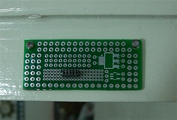

First an update on the PCB I mentioned in my last post.
The PCB came out really well and was useful in fitting the sensors. Below I have also attached the pictures of the STM330 fitted onto these boards.

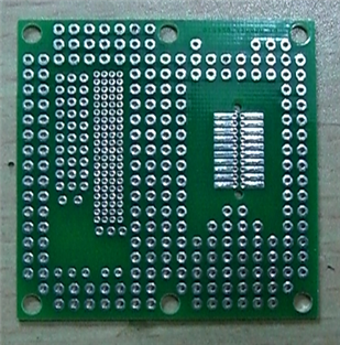

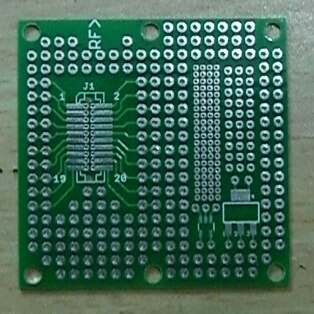

Here are pictures of the PCB on both sides. In case any one wants the design drop me a PM I will send them with the gerber.
Although the PCB was great but I missed on one point. The 2MM connector that were suppose to hold the TCM320C were shorter than required.
The TCM320 has 16 pins but on the current PCB there are only 10 points so that was a no-go. I had an older proto PCB which I used as a backup to make the TCM320 setup.
You can look at this in the video that I have posted at the end of this post. I would be designing another board exclusively for the TCM320 since they would also need transistors to do the actual work.

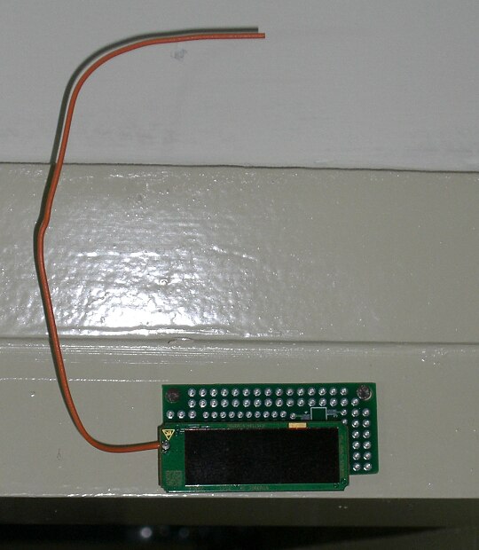

Here are some pictures of how the above PCB was used to fit the sensors. Actually the STM330 does not need any power or connection it just needs a fitment to sit on.
So, I use a small piece of the 1.27mm pitch female connector to just hold the sensor.
And here is how the sensor is fixed on. It works well without interference and tells me the room temperature.
I have checked for the 4BS messages from both using a TCM320C in sniffer mode from the Dolphin View Advance.
