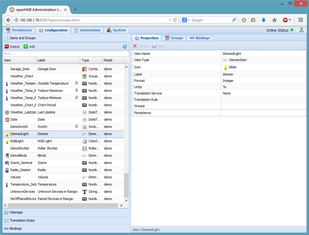

When a recent burglary left me without a PC, suddenly I couldn't rely on the openHAB designer. I was looking for an easy way to continue development and testing. I wanted to be able to edit the openHAB configuration directly on the RPi. Unfortunately, the openHAB designer does not run on the RPi, and even if it did, would no doubt be hideously slow.
HABmin

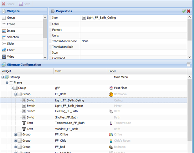

Enter HABmin. It allows you to control and configure a running instance of openHAB, using a straight-forward GUI.
It's tremendously easy to install. From your RPi, download the latest release:
wget https://github.com/cdjackson/HABmin/releases/download/0.1.3-snapshot/habmin.zip
Then unzip to your openHAB folder. In my case this is done with the command:
unzip habmin.zip -d /opt/openhab
Restart openHAB and then you can navigate to the HABmin URL: http://<openHAB IP address>:8080/habmin/index.html
The HABmin interface isn't perfect, but find the workflow much better than using openHAB designer. It's also more convenient, as you can edit on the fly. Even now, when I have a replacement laptop, I continue to use HABmin to configure my openHAB install.
