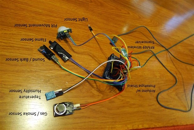

This wireless sensor node covers about half of the sensors I wanted to build for my home automation system.  The purpose of the smoke / bark / fire / movement sensors is to email me when these things are detected.  Like all my wireless sensors, the wireless range is over 700 feet through several walls, so it's suitable for use in large buildings.
  • Bark / Noise Sensor:  Pretty sensitive when pointed in the right direction, and includes a sensitivity pot for adjustment.  I'm using it to notify me if the dog barks.  The system emails me when sound sensor goes off, as well as turning on an indicator on the OpenHAB display.
  • Temperature / Humidity:  I'm including it just for completeness - because what multi-sensor doesn't come with a temperature output.
  • Fire / Gas: Using an MQ2 w/ analog output.  Good for detecting explosive gas (propane, methane, natural gas), as well as smoke.
  • PIR Presence Sensor: Can be used for security purposes, or for room automation
  • Flame Sensor:  The sensor I had wasn't as sensitive as I'd like.  It does a good job of detecting a flame in front of sensor, but must be pretty close.  Might swap it out for something more sensitive in the future.
  • Light Sensor:  For detecting if a room light is left on
I mounted the sensor in a cheap tuperware container.

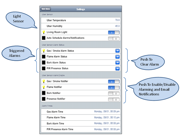

Here's a screen shot of the OpenHAB display and a video of it working.

OpenHAB Item Definition
Switch itm_NAA_auto "Auto Schedule Alarms/Notifications"
Switch itm_uber1_gas_alm_enb "Gas / Smoke Notifer"
Switch itm_uber1_flame_alm_enb "Flame Notifier"
Switch itm_uber1_bark_alm_enb "Bark Notifier"
Switch itm_uber1_pir_alm_enb "Presence Notifier"
Switch itm_uber1_gas_alm_sta "Gas / Smoke Alarm Status"
Switch itm_uber1_flame_alm_sta "Flame Alarm Status"
Switch itm_uber1_bark_alm_sta "Bark Alarm Status"
Switch itm_uber1_pir_alm_sta "PIR Presence Status"
Switch itm_uber1_light_sta "Living Room Light"
DateTime itm_uber1_gas_time "Gas Alarm Time [%1$tA, %1$tm/%1$td, %1$tI:%1$tM %1$tp]"
DateTime itm_uber1_flame_time "Flame Alarm Time [%1$tA, %1$tm/%1$td, %1$tI:%1$tM %1$tp]"
DateTime itm_uber1_bark_time "Bark Alarm Time [%1$tA, %1$tm/%1$td, %1$tI:%1$tM %1$tp]"
DateTime itm_uber1_pir_time "PIR Presence Alarm Time [%1$tA, %1$tm/%1$td, %1$tI:%1$tM %1$tp]"
Number itm_uber1_gas_mqtt "Gas [%.1f]" (ALL) {mqtt="<[mymosquitto:1222:state:default]"}
Number itm_uber1_flame_mqtt "Flame [%.1f]" (ALL) {mqtt="<[mymosquitto:1232:state:default]"}
Number itm_uber1_pir_mqtt "PIR [%.1f]" (ALL) {mqtt="<[mymosquitto:1242:state:default]"}
Number itm_uber1_bark_mqtt "Bark [%.1f]" (ALL) {mqtt="<[mymosquitto:1252:state:default]"}
Number itm_uber1_temp_mqtt "Uber Temperature [%.1f]" (ALL) {mqtt="<[mymosquitto:1262:state:default]"}
Number itm_uber1_hum_mqtt "Uber Humidity [%.1f]" (ALL) {mqtt="<[mymosquitto:1263:state:default]"}
Number itm_uber1_light_mqtt "Light Sensor [%.1f]" (ALL) {mqtt="<[mymosquitto:1272:state:default]"}
OpenHAB Rules
/* Uber sensor rules */
/* -------------  Uber Sensor -------------------- */
rule "Uber Lighs"
        when
                Item itm_uber1_light_mqtt received update
        then
                if(itm_uber1_light_mqtt.state < 350)
                        sendCommand(itm_uber1_light_sta, OFF)
                else
                         sendCommand(itm_uber1_light_sta, ON)
end
/*-----  uber - gas/smoke ---------- */
rule "Uber gas smoke threshold"
        when
                Item itm_uber1_gas_mqtt received update
        then
                if((itm_uber1_gas_mqtt.state > 220) && (itm_uber1_gas_alm_enb.state == ON))
                        sendCommand(itm_uber1_gas_alm_sta, ON)
end
rule "Uber gas smoke response"
        when
                Item itm_uber1_gas_alm_sta changed from OFF to ON
        then
        sendMail("ArduinoHomeAutomationOpenHAB@gmail.com", "gas / smoke" , "gas or smoke detected")
                //playSound("ding.mp3")
                postUpdate(itm_uber1_gas_time, new DateTimeType())
end
/* --------- uber flame ---------- */
rule "Uber flame threshold"
        when
                Item itm_uber1_flame_mqtt received update
        then
                if((itm_uber1_flame_mqtt.state < 900) && (itm_uber1_flame_alm_enb.state == ON))
                        sendCommand(itm_uber1_flame_alm_sta, ON)
end
rule "Uber flame response"
        when
                Item itm_uber1_flame_alm_sta changed from OFF to ON
        then
                sendMail("ArduinoHomeAutomationOpenHAB@gmail.com", "fire detected" , "fire detected")
                postUpdate(itm_uber1_flame_time, new DateTimeType())
end
/* --------- uber bark ---------- */
rule "Uber bark threshold"
        when
                Item itm_uber1_bark_mqtt received update
        then
                if(itm_uber1_bark_alm_enb.state == ON)
                        sendCommand(itm_uber1_bark_alm_sta, ON)
end
rule "Uber bark response"
        when
                Item itm_uber1_bark_alm_sta changed from OFF to ON
        then
                sendMail("ArduinoHomeAutomationOpenHAB@gmail.com", "bark detected" , "dog barked!!!")
                postUpdate(itm_uber1_bark_time, new DateTimeType())
end
/* --------- uber pir ---------- */
rule "Uber pir threshold"
        when
                Item itm_uber1_pir_mqtt received update
        then
                if(itm_uber1_pir_alm_enb.state == ON)
                        sendCommand(itm_uber1_pir_alm_sta, ON)
end
rule "Uber pir response"
        when
                Item itm_uber1_pir_alm_sta changed from OFF to ON
        then
                sendMail("ArduinoHomeAutomationOpenHAB@gmail.com", "pir detected" , "dog pired!!!")
                postUpdate(itm_uber1_pir_time, new DateTimeType())
end
OpenHAB Sitemap
    Frame label="Uber Sensor" {
            Text item=itm_uber1_temp_mqtt
            Text item=itm_uber1_hum_mqtt
            Switch item=itm_uber1_light_sta
            Switch item=itm_NAA_auto
    Frame label="Uber Sensor Alarm Status" {
            Switch item=itm_uber1_gas_alm_sta mappings=[OFF="Off"]
            Switch item=itm_uber1_flame_alm_sta mappings=[OFF="Off"]
            Switch item=itm_uber1_bark_alm_sta mappings=[OFF="Off"]
            Switch item=itm_uber1_pir_alm_sta mappings=[OFF="Off"]
    Frame label="Uber Sensor Alarm Enable" {
            Switch item=itm_uber1_gas_alm_enb
            Switch item=itm_uber1_flame_alm_enb
            Switch item=itm_uber1_bark_alm_enb
            Switch item=itm_uber1_pir_alm_enb
Sketch
Author: Eric Tsai
License: CC-BY-SA, https://creativecommons.org/licenses/by-sa/2.0/
Date: 9-1-2014
File: UberSensor.ino
This sketch is for a wired Arduino w/ RFM69 wireless transceiver
Sends sensor data (gas/smoke, flame, PIR, noise, temp/humidity) back
to gateway.  See OpenHAB configuration file.
1) Update encryption string "ENCRYPTKEY"
2)
/* sensor
node = 12
device ID
2 = 1222 = smoke or not
3 = 1232 = flame detected or not
4 = 1242 = human motion present or not
5 = 1252 = barking or not
6 = 1262, 1263 = temperature, humidity
//RFM69  --------------------------------------------------------------------------------------------------
#include <RFM69.h>
#include <SPI.h>
#define NODEID        12    //unique for each node on same network
#define NETWORKID     101  //the same on all nodes that talk to each other
#define GATEWAYID     1
//Match frequency to the hardware version of the radio on your Moteino (uncomment one):
//#define FREQUENCY   RF69_433MHZ
//#define FREQUENCY   RF69_868MHZ
#define FREQUENCY     RF69_915MHZ
#define ENCRYPTKEY    "xxxxxxxxxxxxxxxx" //exactly the same 16 characters/bytes on all nodes!
#define IS_RFM69HW    //uncomment only for RFM69HW! Leave out if you have RFM69W!
#define ACK_TIME      30 // max # of ms to wait for an ack
#define LED           9  // Moteinos have LEDs on D9
#define SERIAL_BAUD   9600  //must be 9600 for GPS, use whatever if no GPS
boolean debug = 0;
//struct for wireless data transmission
typedef struct {
  int       nodeID;         //node ID (1xx, 2xx, 3xx);  1xx = basement, 2xx = main floor, 3xx = outside
  int       deviceID;        //sensor ID (2, 3, 4, 5)
  unsigned long   var1_usl;         //uptime in ms
  float     var2_float;       //sensor data?
  float     var3_float;        //battery condition?
} Payload;
Payload theData;
char buff[20];
byte sendSize=0;
boolean requestACK = false;
RFM69 radio;
//end RFM69 ------------------------------------------
// gas sensor================================================
int GasSmokeAnalogPin = 0;      // potentiometer wiper (middle terminal) connected to analog pin
int gas_sensor = -500;           // gas sensor value, current
int gas_sensor_previous = -500;  //sensor value previously sent via RFM
//temperature / humidity  =====================================
#include "DHT.h"
#define DHTPIN 7                 // digital pin we're connected to
#define DHTTYPE DHT11     // DHT 22  (AM2302) blue one
//#define DHTTYPE DHT21   // DHT 21 (AM2301) white one
// Initialize DHT sensor for normal 16mhz Arduino
DHT dht(DHTPIN, DHTTYPE);
// flame sensor ==============================================
int flameAnalogInput = A1;
int flame_status = 0;
int flameValue = -50;                  //analog value of current flame sensor
int flameValue_previous = -50;  //value previously sent via RFM
// Light sensor ===============================================
int lightAnalogInput = A2;    //analog input for photo resistor
int lightValue = -50;
int lightValue_previous = -50;
// PIR sensor ================================================
int PirInput = 5;
int PIR_status = 0;
int PIR_reading = 0;
int PIR_reading_previous = 0;
// sound sensor ==============================================
//sound sensor digital input pin
int soundInput = 6;
int sound_status = 0;
int sound_reading = 0;  //reading =1 mean no noise, 0=noise
int sound_reading_previous = 0;
// 2 = 1222 = smoke or not
// 3 = 1232 = flame detected or not
// 4 = 1242 = human motion present or not
// 5 = 1252 = barking or not
// 6 = 1262, 1263 = temperature, humidity
// timings
unsigned long gas_time;            //sensor read time
unsigned long gas_time_send;    //sensor value transmission time
unsigned long flame_time;
unsigned long flame_time_send;
unsigned long pir_time;
//unsigned long pir_time_send;
unsigned long sound_time;
//unsigned long sound_time_Send;
unsigned long temperature_time;
unsigned long light_time;
unsigned long light_time_send;
void setup()
  Serial.begin(9600);          //  setup serial
  //RFM69-------------------------------------------
  radio.initialize(FREQUENCY,NODEID,NETWORKID);
  #ifdef IS_RFM69HW
    radio.setHighPower(); //uncomment only for RFM69HW!
  #endif
  radio.encrypt(ENCRYPTKEY);
  char buff[50];
  sprintf(buff, "\nTransmitting at %d Mhz...", FREQUENCY==RF69_433MHZ ? 433 : FREQUENCY==RF69_868MHZ ? 868 : 915);
  Serial.println(buff);
  theData.nodeID = NODEID;  //this node id should be the same for all devices in this node
  //end RFM--------------------------------------------
