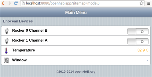

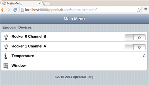

Now the problems are
1. While loading the site, temperature is not displayed. After some time( after next transmission, I guess ) temperature is updated to UI. But if I again reloads the page, it disappears.
2. Even if I'm closing and opening my reed switch with the magnet provided, this is not updated to the UI. UI always stays blank for my reed switch. Additionally, if I'm trying to reload the page, I'm getting this WARNING in openHAB runtime terminal

    Now my Contact sensor is working image I forgot to add <contact> it seems.
    And after closing the designer, temperature is also stable image
    Thanks a lot!!
