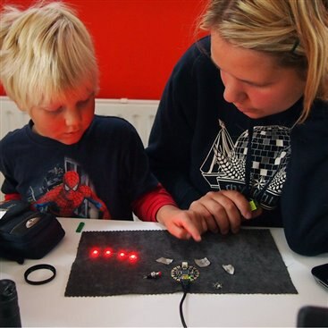

Aside from playing with the colors from the color sensor, I also had a bit of fun coming up with ideas for the actual game! It had to involve at least some colors of course image First I made sure that the buttons made from conductive fabric worked. And I must say they work excellent! It's such fun to include those in my project! And real easy too. So the game works.. You can touch the button that corresponds with the same color as the viewfinder pixel and you'll see a very nice green 4-pixel-lightshow (I had so much fun writing the code for this bit, it's so nice to know what you're doing and immediately see it in the pixels!). If you'd touch one of the other buttons, you'd see 4 red pixels. I asked my 5 year-old to play the game and this is what happened when he touched the wrong button! He also got it right, but I'll have to make a video to show you later on.

    It's very cool to see your update and I so admire your language capabilities -- can't wait to take a C++ course as most of my issues are coming from the programming side.   I really connect with the cartoon except that there is usually about 4-5 hours in between my issues/researching before the "victory" pose.  Anyway, I love seeing your son in the pic playing with the game.  I really think this is something that a children's toy company would want to get into -- soft and tech.  Looking forward to seeing the action video.

    I'm proud to say I got myself out of a few coding problems image I still couldn't do it without Victors help, but this is my project, so I'm the one doing the coding! When I'm stuck he gives just the tiniest hint and then lets me find my own solutions. Frustrating! But also very good! Because now I can say that I wrote 75% of the code, and I even understand what I wrote image
    And while coding I'm constantly talking to myself, making sure I know what I'm doing.. I seems to help a little bit. It's still very hard!
