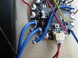

Jeej! I finished my entire project today image And I'm pretty happy with the result too! Last night we finally finished the colorissues as well as the conductive fabric buttons and we could put the whole camera together.
Yesterday I showed you a picture of the inside of the camera as it was then. Here's a picture off what it looks like now:
In the end we used the CapacitiveSensor library to get the conductive fabric buttons going. CapPin library looks very nice, but doesn't work on battery power, only when connected to USB port (found that out last week)! The other option was to use the CapacitiveSensor library (mentioned here: http://learn.adafruit.com/capacitive-touch-with-conductive-fabric-and-flora/code). This uses one extra pin (additional to the button pins) and some resistors. Originally a buzzer was planned to make a sound at fail or succes, the pin meant for the buzzer could be used to drive the capacitive buttons. So: no buzzer, but working conductive fabric buttons.

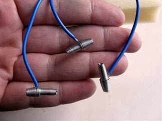

The ends of the blue wires are soldered to springs. In those springs you can also attach the conductive thread that leads to the three buttons. This is necessary because otherwise I would never be able to savely remove the foam from the camera! image

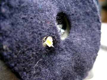

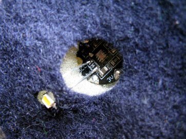

As said, we also came up with a briljant idea to ensure the best possible colorsensing! We thought that the sensor couldn't pick up the right colors because of the interference of the onboard LED. It shines nice and very bright.. So Victor used his insane solderingskills to desolder the LED from the pcb and then soldered it to two pins which he then soldered back on the pcb.. Crazy stuff! But all worth it in the end, because it works so well!

    Wow, that's so interesting about the CapPin library not operating on battery.  I wonder why that is?  Is it the different voltage?  I had another project where I had to use a CapSense library.  It was going well until they did an update, and then I got stuck.  It wasn't until I met Leah Buechley herself, that I was able to muddle through things.  Her student had done a CapSense piano and I was able to hack that code. BTW, the move of the LED to another location on your camera was so wise.  Tell Victor he is a true hacker in the best sense.  I'm so happy your project has continued this way and I love your choice of primary colors for the wiring.  Women really ought to be part of circuits more often because they are art!
