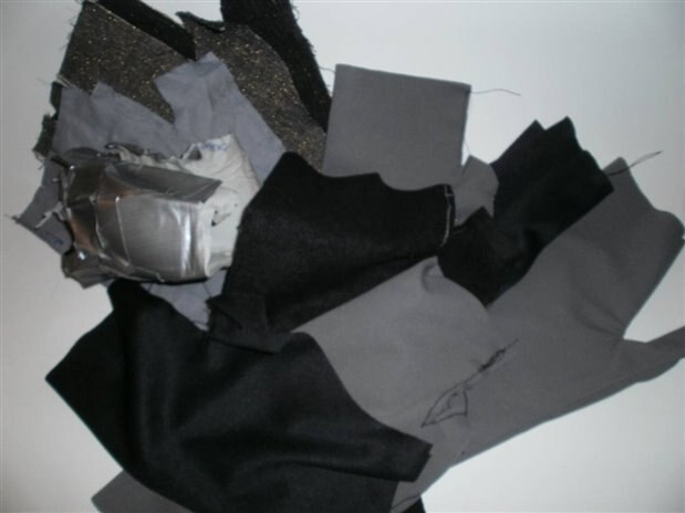

These past weeks have been a marathon of sewing. Pictured here is just a fraction of the aftermath. My living room is in need of some love.
There is a duct tape dummy (of my hand), broadcloth and sparkly denim patterns, black microsuede failure, black nylon failure, and grey stretch knit (more successful) prototypes.

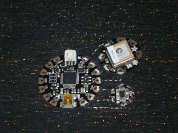

Here are the brains of the project, secured to my denim backing. I am pleased with my stitches. This time.

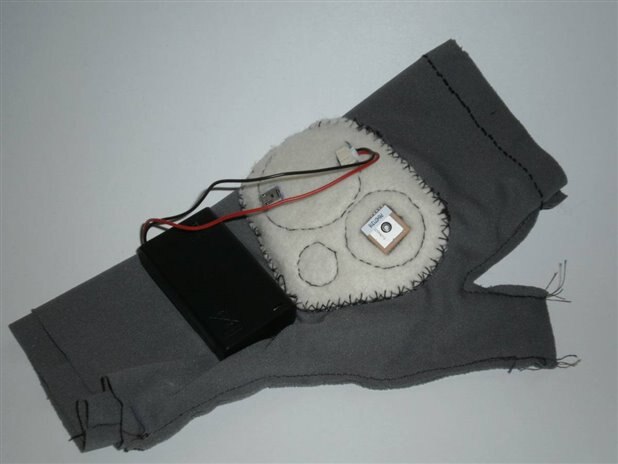

Here they are installed on the back of my glove. You can see that I cut out the patch from the denim and basted/blanket stitched a piece of felt as padding. The weird pillow is then whip stitched to the knit fabric underglove.

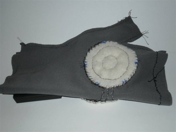

Here is the palm. The circular group of NeoPixels received a similar treatment. The felt is now padding AND light diffuser. You can also see the coiled stitches between the NeoPixel array and the back of the glove here. This allows the circuit to flex and stretch easily around my hand without making short circuits. The stitches are less neat because it was 2AM.

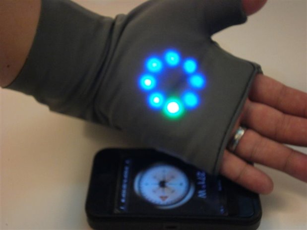

And here is a "perfectly lit" picture. Note that the outer glove conceals the magic underneath when the LEDs are off. Watch the video to see that somewhat less stunning effect.
Totally points North!
