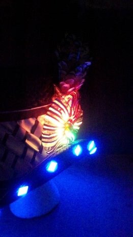

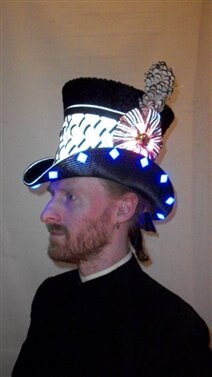

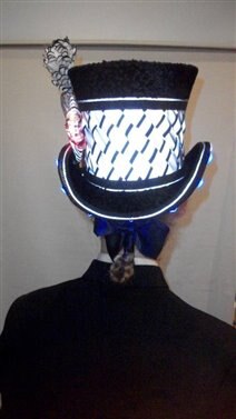

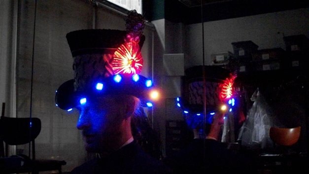

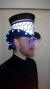

Before I began the final assembly, I did one more calibration test using the Flora. I had noticed that where the battery was in relation to the magnetometer had an effect on the heading reading. So I put all of the components in their place on the hat and re-calibrated it. I got different numbers from before and used them in the sketch. I was pleased with the results, it tracked smoother and truer to North. Now I was ready to commit to putting it all together.
With all the pieces ready for assembly, I sewed the crown to the brim. It is now a hat. I left an opening on the left side for all of the wires to pass through. There were a lot of wires and I was glad that I had carefully labeled them all. I went through and systematically soldered each component and put on heat shrink tubing before sewing it to the hat. I accidentally broke the data wire off of the cockade by handling it roughly. I had to hold back the organza ribbon and try to solder in a new lead. I ended up scorching the ribbon a bit, but it is the back side and not very noticeable.
Here is a step by step video of the final assembly. (no sound)

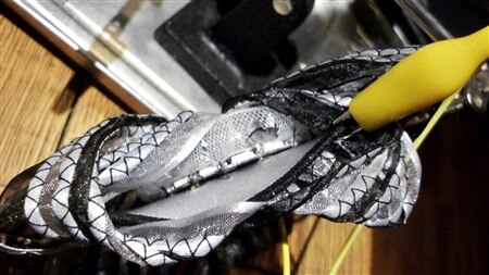

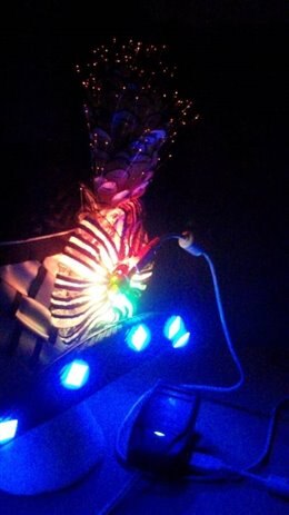

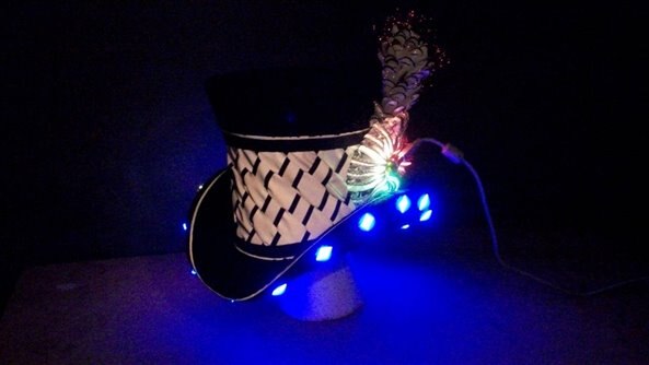

After all the components were soldered and sewn into place, I plugged in the battery and got a little surprise. Those fussy through hole NeoPixels in the fiber optic spray didn't turn on. They came on as the bootloader was running, but then shut off as the rest of the program began. I thought perhaps some faulty wiring on my part, but before opening everything up I plugged in the USB cable. Everything worked just fine.
I thought that perhaps it was a 5 volt vs. 3.7 volt thing. I wired up 3 AA batteries to a JST plug to test 4.5 volts, the fiber optics did nothing. I have run out of time now, but for the future I think I want to try one of Adafruit's 5 volt regulated power boosts to see if I can get better performance. For now, the brim and the cockade work nicely and I took pictures and video with and without the USB cable.
Special thanks to Meg Weedon for my hair, and John Baird for the photos and videos of me.
