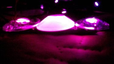

I wanted to use an acrylic jewel over each NeoPixel to act as a diffuser. I did a test with three different types of jewels. I drilled out a shallow hole in each jewel with a dremel and set them over the NeoPixels.
Pictured on the left is clear acrylic, in the center is white opal, and on the right is aurora borealis finish on clear. I really liked the look of the white opal jewel the best. It really spread the light and made it visible from the side nicely as well. The white opal finish is not as opaque as milk white acrylic, so it allows more brightness through. I found some small square white opal jewels that just fit over the footprint of the NeoPixel. After drilling out a small hole, I used crazy glue to glue them over each NeoPixel.
