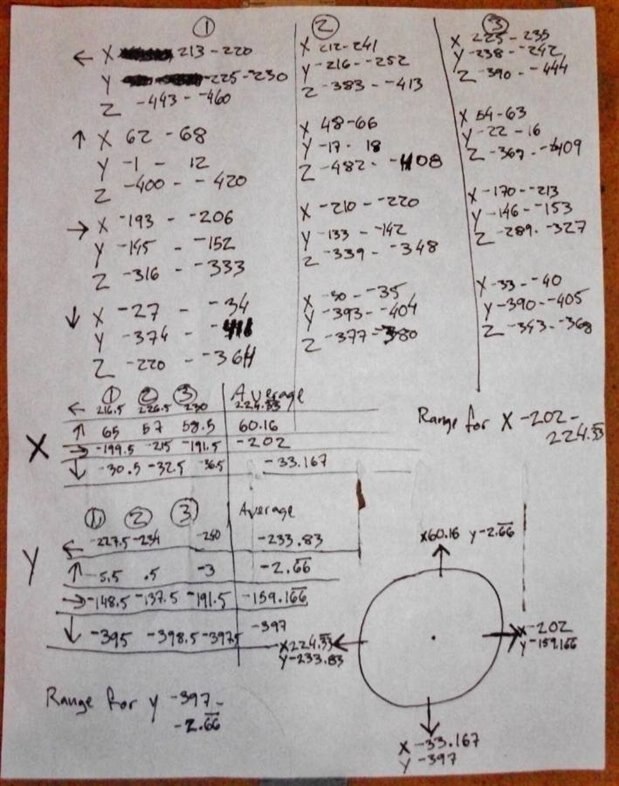

So, I reloaded that test code onto my Gemma and did some tests. I put everything neatly onto a breadboard with the NeoPixel ring directly above the magnetometer which was directly above a key chain compass. I drew a line with the x and y axis printed on the magnetometer onto a piece of cardboard, and taped my breadboard to it. Then I taped out a clock onto my work surface and set a ruler to point north according to my compass. I then recorded the position of the dot of light when I turned the cardboard to point to each hour. This is what I got:
Not very reliable. But the results were repeatable, so something had to be off. So I went back to the learning site at Learn.Adafruit.com to see what I could learn. I already knew that my accuracy was going to be compromised because I had deactivated the accelerometer and couldn't compensate for tilt. I found a calibration sketch with the original library, so I loaded it onto my Flora, hooked up the accelerometer, and plugged it into the computer to read the serial data.
Here is the code I used:

Then I took my taped down cardboard setup and recorded the max and min values for x, y, and z in four directions. The numbers were a bit jumpy, so I let them settle well before noting the min and max. I did this process three times. Then I took the average of the min and max for each time, and then the average of those three numbers to establish the average number for each direction.
Now I had established the range for x and y. Z seemed to be superfluous. I found in a bit of code from one of last years contestants that these numbers could be used in the by mapping them to the total sensor range.
int16_t x = map(lsm.magData.x, -202, 224, -1000, 1000);
int16_t y = map(lsm.magData.y, -397, -3, -1000, 1000);
I made these changes to my code, but had to comment out my "tracer" pixels because there wasn't enough room. Getting a functioning compass was priority one. I did the same controlled setup with much better results.
The dot of light stays mainly between 9 and 11, so I am calling this a success for the moment. Next, I needed to see if it were possible at all to light up the rest of my planned rig. 16 pixels around the brim, a ring of 16 at the cockade, and two pixels in the feather for a total of 34 pixels. Since space on the Gemma is so tight I am going to have to get really clever. In my original code, there is a colorwipe function that blacks out the previous pixel lit so only the current sensor reading is displayed. I discovered that I could use this bit to light other pixels in my rig if I used a color instead of 0,0,0. I set the last two pixel colors manually so that my feather could be a different color from the rest of the hat. I tried to compile this with the Arduino IDE and it compiled at 5,312 bytes out of an allowable 5,310. Two bytes to big! I then loaded this same code onto codebender and tried to compile it. It compiled it at 5, 300. Ten bytes to spare! I think I am going to continue to develop my code on codebender because it seems to have a better compiler for my current needs.
