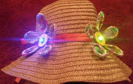

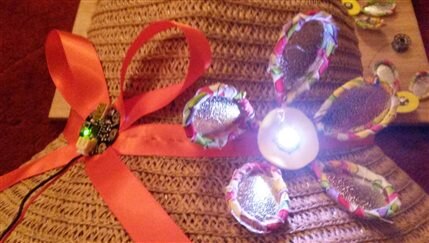

After making all the components, it was time to take the bull by the horns and sew everything onto the hat with the conductive thread. To be honest I was a bit worried about this because I didn't want to mess the hat up at this point. I had a look at the Adafruit website and found an overview on how to work with the conductive thread (https://learn.adafruit.com/conductive-thread/overview). (This is a good overview that explains (better than I ever could) how to work with the conductive thread.) With my new found confidence I started to sew everything on to the hat. I decided to work in stages so I sewed the NeoPixel on to the hat first, followed by the switch and then the first NeoPixel flower. Once everything was deemed ok with this circuit I carried onto the next flower. By working in stages I could test to see if the circuit was working along the way and if there was a problem (i.e. the NeoPixel wasn't lighting up) I knew that it was the last section I had sewn.
So that's the hat sewn all together. The next task is to hide the battery!

    sbi3clp over 11 years ago in reply to DAB
    Thanks.
    I'm going to give your ping pong ball suggestion a go. I just need to go and get some.
    Claire
    DAB over 11 years ago
    Looks good.
    I would put something translucent over the LEDs to cut the brightness a bit.
    Other than that, I think you are on track.
