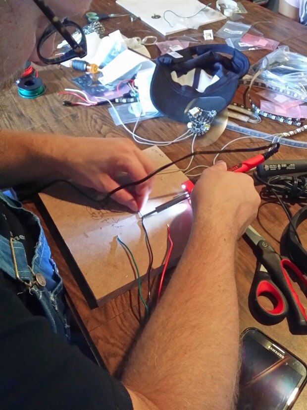

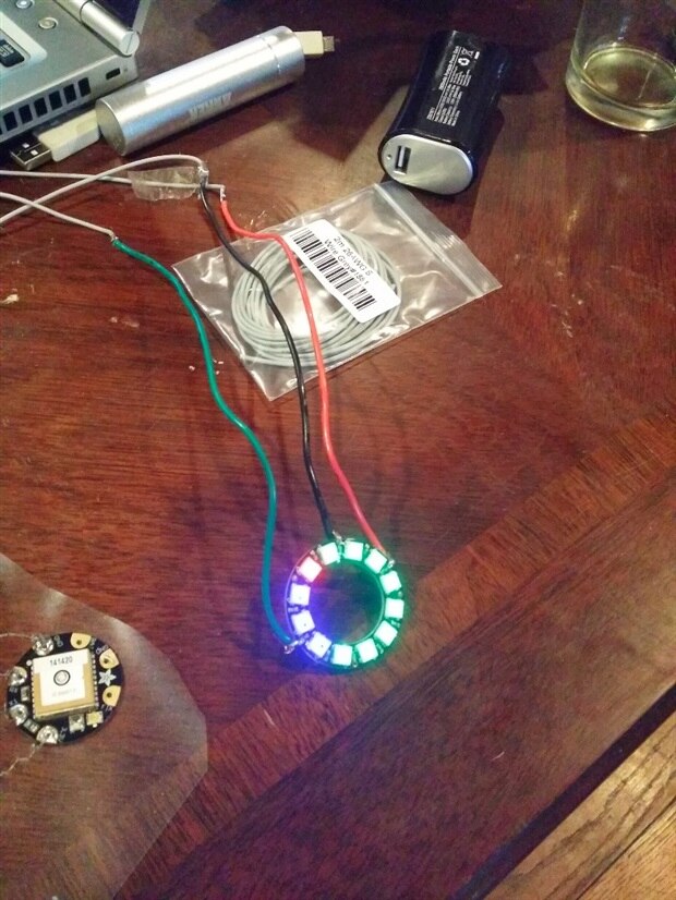

Moving right along, you will hear in the video that we were not getting a good connection on the GPS and other components.
It is really important that if you use conductive thread that you sew it tout around the pads of your electronics or you won't
be able to get a good connection. It's like having a lamp plugged into an outlet,  but the extension cord is not plugged in all the way,
your light may flicker when you move that cord however,  once you push that cord into the wall socket , your light is now getting
the right about of current and you have a steady light. Conductive thread is like that. Make pretend its a wire and if you don't hook up
the wire correctly, you won't have a good connection.

You will see from the video that the Neo Pixels are very bright and as much as i would have liked things to look better,
sometimes it's just out of our control. The software on the computer wasn't easy to record,  so next week Kyle will do a writeup to explain
it in detail. We really want someone who has never done any electronics no matter what their age,  will learn something from our project.
