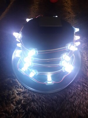

While I was prototyping the hat (below) I figured out a way to add additional functionality to the project by adding lights into the brim of the top hat to create a ring light.
Below is a string of LEDS I tied around the top hat which I am using to determine the amount to be used.

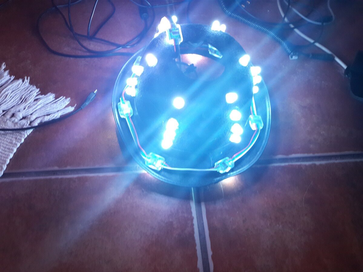

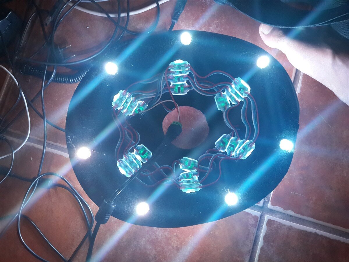

I applied this same idea to the top hat. First testing it out on a round piece of glass I could attach leds to and then applied it to a prototype hat. This hat being a cheap costume shop bowler hat I could roughly melt holes through to fit the leds to see if they would fit and look ok. A hole had to be cut in the top of the hat so that the hat could be take off and used as a ring light when needed while also retaining its light when worn on the head.
Above is a photo of a willing friend to test the ring light’s lighting effect in this configuration
So in this configuration the LEDS work really well! I am going to attempt to put 50 LEDs in the hat which is powered by a 5v portable cellphone charger which is rated as a 5v 2a 2600MAh charger which should be more than enough.
Each LED is said to use 60mA at max load but in most practical scenarios, the LEDs won’t be fully bright with all blue, green and red lit up at the same time so it’s safe to assume each LED will be using around 20ma at a given time. This means that I could should expect about 2.5 hours of run time on the 2600mah battery. This is perfectly acceptable to me and as I have an extra one of these batteries, the lighting display could potentially last for the whole party!
