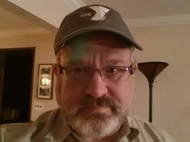

Done!  The code’s already downloaded from the breadboard test, so all I need to do it connect the battery and try it out.  I tried it on, and took a selfie with my phone – it looks pretty innocuous from the front.  You can sort of see the green glow from the LED reflecting off my forehead, telling me that there’s currently nobody sneaking up behind me.

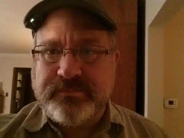

Here’s a different angle, with a warning that the bookcase is about to grab me!
And as I step forward, away from the bookcase, the warning changes to yellow (which is pretty white in this photo -- I may need to adjust the color).

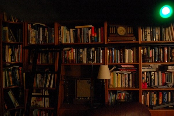

Here’s a couple POV shots of what it looks like wearing the hat.
In this one, the wall behind me is close enough to deserve a warning.
But when I take a step forward, I'm safe. (I had to turn the lamp off to avoid overexposure from standing too close).
