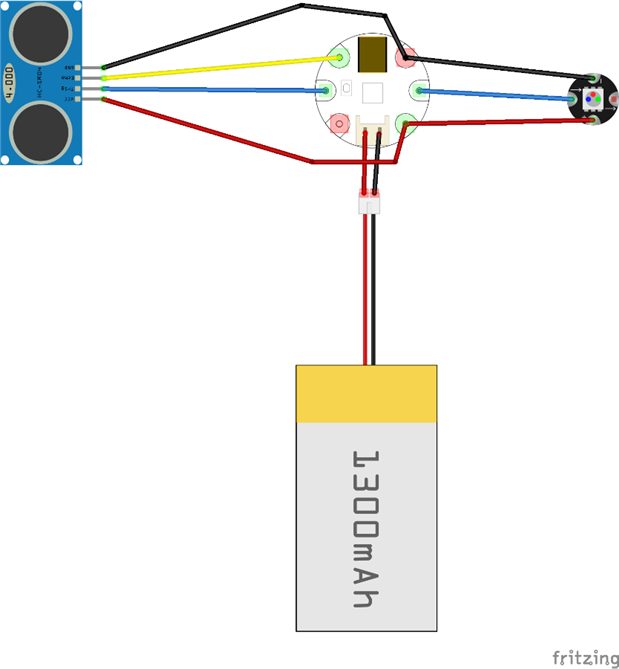

Details required if you want to build your own Spy Hat!
Parts list: Gemma, battery, HC-SR04 (or similar) ultrasound sensor, NeoPixel
And the code:
    Spy Hat code
    AdaFruit Gemma Hats Off Challenge
    Oct 30, 2014
    This code was written for the Spy Hat project in the Adafruit Gemma Hats Off
    Challenge.  It reads distance from an HR-S04 ultrasound sensor, and reports
    the distance as a color on an AdaFruit NeoPixel (green = no measurement,
    yellow is the most distant measurement, and shades of orange gradually
    moving to red show closer measurements.
    D. Bowden
