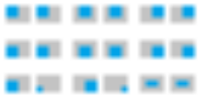

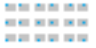

  • A emoticon hat: light up LEDs to form various emoticons depending on users mood. Happy, sad, angry, excited – limited by size of hat (0.5” per NeoPixel)
  • A wandering eyes hat: one or two matrices of LEDs making up two eyes that will look up, down, left, right, wink, blink, and possibly change colors randomly as the wearer walks around. Again, number of pixels limited by size of hat (0.5” per pixel)
    • 9 pixels per “eye” (3x3 square) would require 18 NeoPixels, but would allow only 1 (lit) pixel “eyes”, so very low resolution. However, possibly an overlay with drawn lines on translucent material may help? Winking / blinking can be done by dimming or turning off one or both “eyes”.
    • The size can be increased to 4 (lit) pixel eyes, giving 4 corners of eye movement (up&left, up&right, down&left down&right. One more column of pixels per eye (3x4 rctangle) could give up/down/center in addition, needing a total of 24 pixels.
    • Larson “scanning” modes are possible as bonus.
    • Control with tilt switches?
