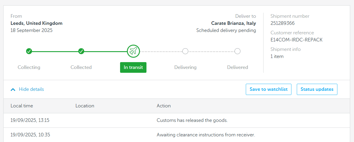

Looking forward to receiving my TDK evaluation kit!
