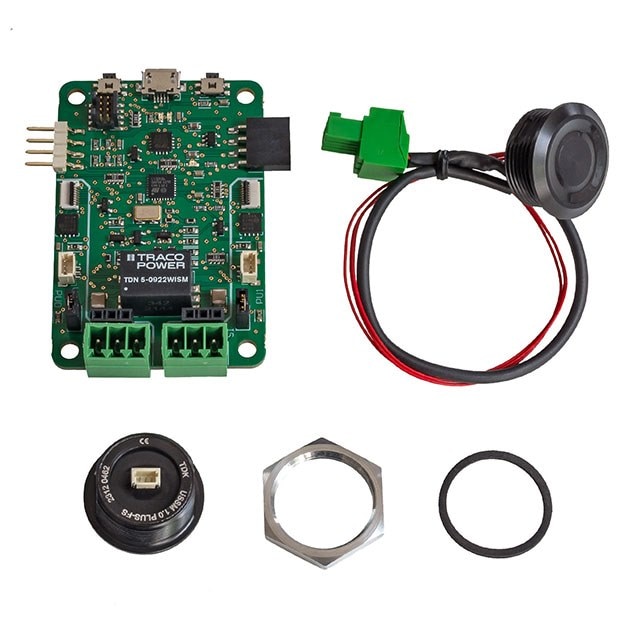

Exploring the Kit
This time I received the kit without any hassle - Thanks to TNT and element14 team for that.

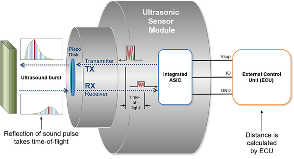

The USSM1.0 PLUS-FS is an ultrasonic pulse-echo product intended for range-finding and presence-detection applications.
image             image
image courtesy: TDK Electronics
Key Features and Technical Advantages
The main feature of the USSM plus-fs for this project is the combination of robustness and advanced signal processing:
Integrated ASIC and Driver: The module is an all-in-one package. Single transducer can be used for both Tx and Rx or two of them can be paired together. The sensor includes the piezoelectric transducer, the necessary driver circuitry, and a high-end Application-Specific Integrated Circuit (ASIC) for signal processing. This integration handles complex Time-of-Flight (ToF) calculations internally, delivering clean, reliable digital range readings to the connected microcontroller (like the nRF5340 - for my project). I'll be using the 'single mode'. The range can be around 18cm to 5m. Detects transparent surfaces, insensitive to object color and density, which is important for this project. Also it has high immunity against electromagnetic interferences (EMI) noise, maybe helpful as I'll be using the wireless communication.
Mechanical Decoupling (Vibration Immunity): The piezoelectric disk, is physically separated from the main housing. I am not sure whether it's through a matching material or something else [which is not clear to me]. However, mechanically decoupled sensor element is a critical industrial feature. External mechanical vibrations can produce the false measurement result. It's good to see that this sensor has good immunity to the vibration, and I would like to check it out during my experiments.
Robust Environment Performance: The sensor has a compact, durable, water/dust protected chassis integration up to IP65/67 (EN60529). I'll check it's performance to dust, water splashes, and even temporary submersion. It's essential for outdoor water tank monitoring. It works in a wide range of lighting conditions, including full sunlight to complete darkness.
Power Down Mode: An interesting feature that gives me the opportunity to  make it more energy-efficient. The inclusion of a dedicated Power Down Mode is crucial for battery-powered projects. I need to check it out - I think it can be activated by sending a command to the sensor using bidirectional IO (3-wire) communication interface.
**I'll cover more details in my second blog on the transducer itself. I had a previous experience of housing raw piezoelectric transducer in a PVC tube with matching material, backing material prepared from epoxy resin. I'll try to prepare a writeup on that too - it was interesting and I hope others will like it.
