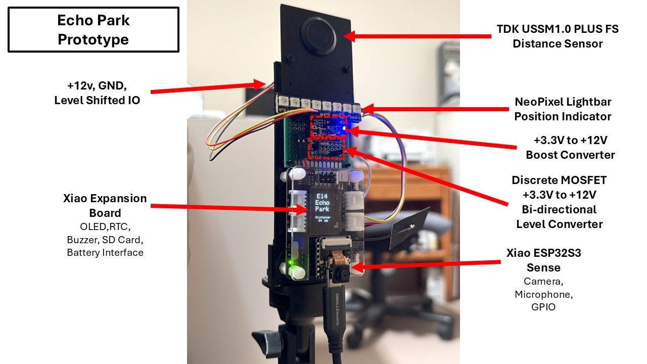

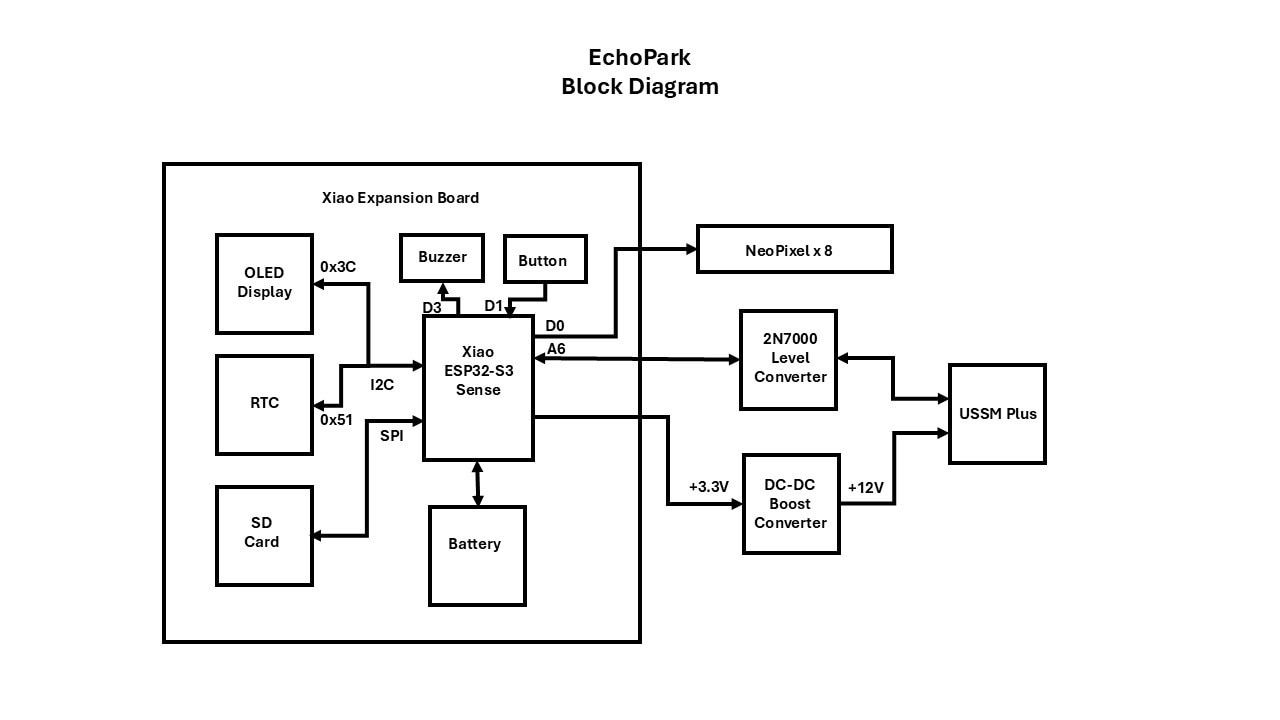

Hardware Description
Features
  • Ultrasonic Sensor measures vehicle position from 225cm to 50cm
  • Visual indication of position in 25cm steps
  • Audible and Visual feedback when position is less than 50cm
  • Onboard display of measured distance
  • Vehicle identification using License Plate Recognition (LPR)
  • MQTT notification of vehicle parked
Block Diagram
Components
Module BOM
Component Description Qty Link
TDK USSM1.0 PLUS-FS ULTRASONIC SENSOR, 74.5KHZ 1 www.newark.com/.../82AK9947
Xiao ESP32S3 Sense Xiao ESP32S3 with OV2640 Camera 1 www.seeedstudio.com/Seeed-Studio-XIAO-ESP32S3-Sense-Pre-Soldered-p-6335.html
Xiao Expansion Board Xiao Expansion Board with 0.96 OLED 1 www.seeedstudio.com/Seeeduino-XIAO-Expansion-board-p-4746.html
DC-DC Boost Converter 3.3V to 12V Boost Converter 1 www.amazon.com/.../B08M19C7MM
2N7000 MOSFET N-Channel MOSFET 200mA 60V 1
DC 5V Active Buzzer Electromagnetic Buzzer 2300Hz 85dB @10cm 1
Carbon Film Resistors Various values 5% 1/4W 3
NeoPixel Stick 8 x 5050 RGB LED with Integrated Drivers 1 www.adafruit.com/.../1426
JST SH 1.0mm pigtail 3 Pin Male Connector with 20AWG 20cm wires 1
I will defer the detailed hardware description to the final project blog post but will show the operation of the prototype assembly that I am testing.

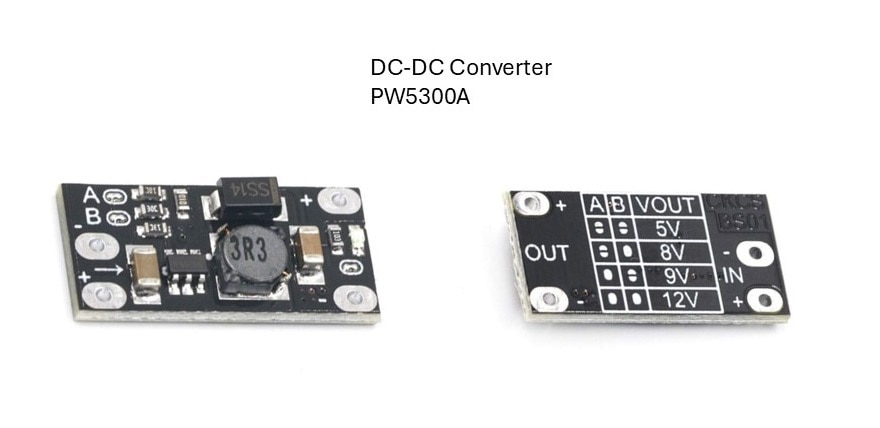

Boost converter
The first component that I checked out was the DC-DC Converter.  I didn’t expect any issues because it is using the PW5300A part which has far more capability than is required for this simple circuit and it is switching at a fixed frequency of 1.2MHz.
The input to the converter is the output of the 3.3V regulator on the Xiao ESP32S3.  The documentation states that you can draw 700mA from the regulator, but I’ll need to be wary of too much WiFi activity.  I want to use the 3.3V because I’d like to have the ability to run off a battery if I want to use this project in a portable mode.
The output of the converter by default is 12V but is selectable to 5V, 8V, or 9V using pad jumpers.  I decided to leave it at 12V to match the setup on the Demo board.  The USSM is capable of running down to 8V but it is easier to correlate when setups are the same.
The output was at 11.98V with reasonable output ripple.  I will document this in the final blog.

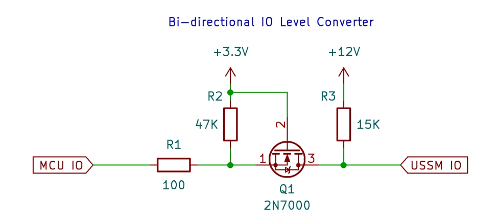

Level converter
Since I only have to translate a single IO pin for the sensor I decided to use a discrete MOSFET circuit rather than use a 4 channel BSS138 level converter that I have from Adafruit.  It will also make it easier to make changes to the pullup resistors in case that is necessary.
My primary concern with this circuit is that I am using a relatively old N-channel FET so the on resistance and VGS threshold are higher than more recent parts.  The typical values for this part should be fine for this circuit but if I get a part that is on the high side of the specification it could be marginal.  E.G. the typical VGS is 2V but max is 3V.  The currents are under 1mA for this setup so that helps.  I tested the converter statically and everything looked good (under 10mV).  I also observed it on a scope and it was switching cleanly but I may reduce the 15K pullup on the USSM side to get better transitions (when I copied the circuit from the reference manual I did not account for the extra 10K pullup in the cable – that was pointed out by another challenger).  I am doing the testing using my handheld scope and I haven’t set up the USB interface to my PC yet so some of this documentation is being deferred until the project blog.

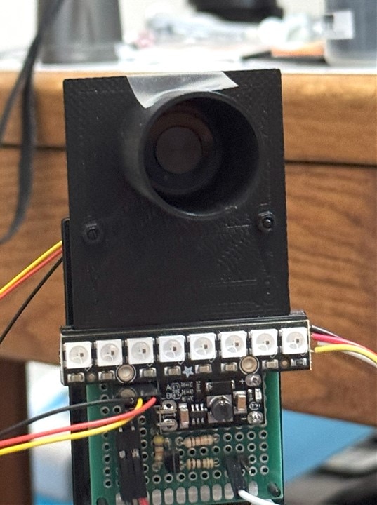

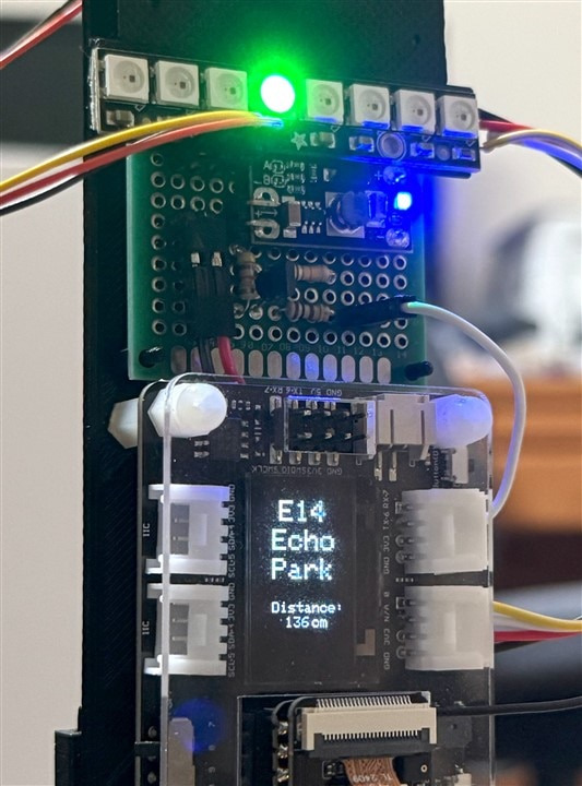

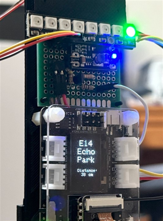

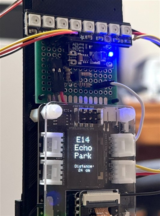

Distance visual feedback
Dave Beacon had mentioned in a comment on an earlier post that I could use an LED pixel strip as a horizontal light bar that illuminated more pixels as you got closer then flashed solid red once you reached zero distance.  It turns out that I had an Adafruit 8 NeoPixel strip available so the following is my first implementation attempt.  I am just lighting a single pixel that moves across the strip based on distance, but I may change that later.  My initial testing was in my office, so my “zero” distance was 25cm and 25cm steps from right to left as distance increases.
The following pictures show the progression of the pixel lighting based on the distance that is displayed on the OLED screen.
I haven’t implemented blinking all the LEDs red at the “zero’ distance, but I will do that later in addition to adding an audible alarm using the buzzer.
One thing that I had forgotten about is how bright these NeoPixels are.  It’s recommended that you run them off a 5V supply, but I usually connect them to a Grove interface, so I run them on 3.3V.  I had left the intensity at 100% and when testing I had one light up when I was looking directly at it, and I had flashes in my vision for about 10 minutes.  I’ve reduced the brightness to 30% while testing.

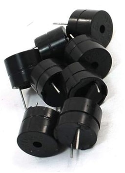

There is a passive buzzer on the Xiao Expansion board down next to the MCU.  I was going to use this as alarm when the correct parking distance was reached.  When I tried the test program I didn’t hear anything.  It turns out that I had cut the jumper trace to the buzzer so that I could use that GPIO pin elsewhere.  I restored the connection, and the buzzer was audible but not very loud.  This is a passive buzzer driven with a PWM pattern on the GPIO pin.  I then recalled that I have never had any luck with these passive buzzers.  I had probably cut that trace earlier because it was a waste of a GPIO pin…
I also recalled that I had purchased a bag full of active buzzers to address this problem.  These are relatively small (12mm diameter x 10mm tall) and even though they are rated at 4-6V, they work well at 3.3V.
So, I added some jumper wires to the GPIO and ground, mounted it near the level converter, and proceeded to test it out. The sound level was good, but I’ll have to see whether it can be heard in the vehicle (might be difficult with the windows up and the engine running). I then encountered something that I hadn’t considered – my distance measurements were all messed up. The resonant frequency of the buzzer is 2300Hz, but that all must have been reflected at the sensor because of where I had mounted it. I repositioned the buzzer behind the assembly and pointed upward and that corrected the problem.  I am going to mount the LED strip and buzzer separately from the sensor assembly in the final version, so hopefully this shouldn't be a problem.

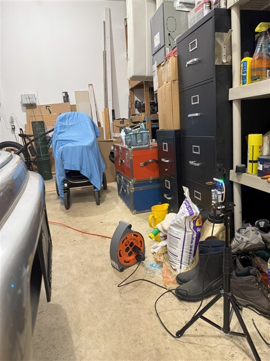

Testing in the garage
Time to do some testing in the garage. I have changed the "zero" distance to 50cm.  For the first test I positioned the sensor assembly at the garage door and just walked toward it. I couldn’t find a small “vehicle” handy that I could attach the cell phone to, so apologies for the shaky video.
Echo Park Distance Test
Then I did a quick test with the sensor pointed at the front of the car.  I was somewhat surprised that the sensor actually alarmed at 50cm and stopped at 53cm.  Of course, this was not a dynamic test and I’m realizing that it might be a real challenge trying out to figure out how to document that.  Maybe if I had a dashcam...
Parking Distance 50cm
At 53cm the first pixel lights and the alarm stops.

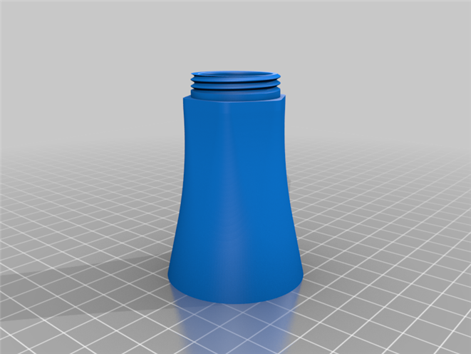

    Would it be worth trying to fit a tube in front of the sensor to make it more directional ?
  • ralphjy
    ralphjy 11 months ago in reply to beacon_dave
    I have considered a tube.  I don't think it will help much on the transmit end but it should help limit the direction of the received echoes.  I've read that the tube needs to be lined with sound absorbing material to minimize reflections in the tube.  Supposedly the felt pads used for furniture protectors will work.  I'm not sure how to size the diameter and height
    I actually have something that I had printed for another project that is probably too small but looks cool Stuck out tongue winking eye.
    I need to get some felt and try printing some bigger tubes...  I've read that conical shapes might work better but would be harder to apply the liner.

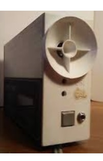

    The old 'Sonic Tape's used to have quite a trumpet.
    Both on the inside and the outside by the looks of it.
  • ralphjy
    What is that?  Do you have a link?

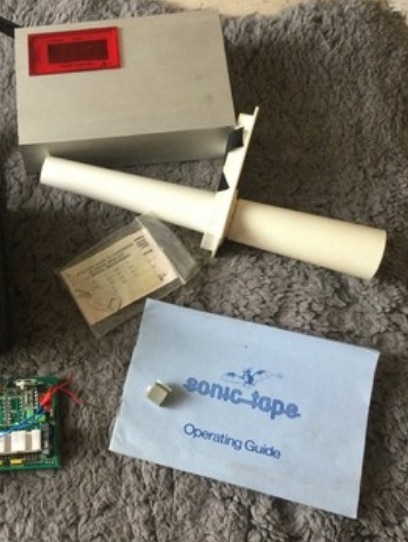

  • beacon_dave
    beacon_dave 11 months ago in reply to ralphjy
    Very old ultrasonic tape measure. I last used one around the early 80s.
    That earlier photo shows the front pulled off so the sensor would have been at the back of the case below the LED display.
    https://www.ebay.co.uk/itm/126179011703
    https://www.ebay.com/itm/235371356375
    It had two different modifier trumpets if I recall correctly.
    Looks like Sonic Tape Ltd UK designed it and Cynex Manufacturing Corp. of Hillside N.J marketed it in the US.

  • ralphjy

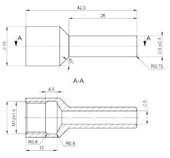

    Ok, thx.  Hard to relate to that without some context (frequency, dimensions, etc.).  It doesn't appear that the trumpet has any sound absorbing material.  I've seen conflicting recommendations about use of absorbing material.
    I've seen sound tubes for PIL Sensors, but they are used only on the short range (400mm), high frequency (360KHz) sensors.  Looks like a straight tube with a funnel on the sensor side and and no sound absorbing material
    .image
    I've also seen the SR04T - Ultrasonic distance sensor cone on Thingiverse that is designed for a 40KHz sensor.
    I guess I'll just try printing some stuff and see how it performs...
    I thought that first drawing was a bootlace ferrule for a second...
