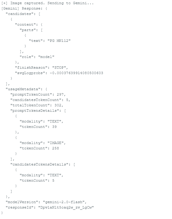

  • Send an HTTP request (with encoded image) to Gemini Vision API to detect and extract the license plate characters
  • Send JSON doc with timestamp license plate data via MQTT to Node-Red for display

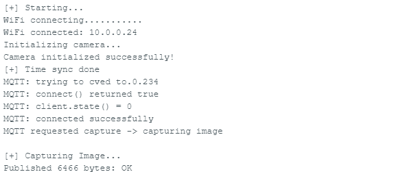

Serial Monitor output showing the program flow:
  • WiFi connect
  • Camera initialization
  • Sync RTC
  • Connect MQTT
  • MQTT request image capture
  • Capture image
  • MQTT Publish Image
  • Send data to Gemini
  • Gemini response
  • Parsed data
  • MQTT Publish Time and PlateNumber

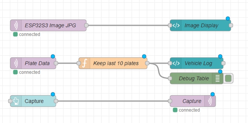

Node-Red Flow
  • Receive Image Data and display
  • Receive Time and PlateNumber and display
  • Send Capture request when button pushed

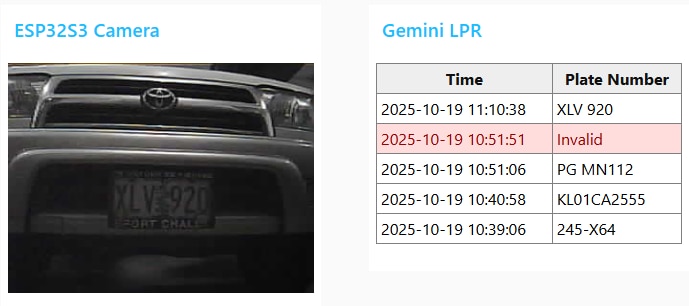

Node-Red Dashboard
There are 3 groups on the dashboard:
  • ESP32S3 Camera - displays the last captured image
  • Gemini LPR - displays up to the last 10 plate data responses from Gemini, latest is on top
  • Command - Capture button to send capture request

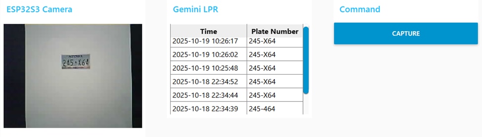

Video demonstrating dashboard operation:
  • Images are various sizes of license plate images
  • Initially you will see stale data in the Gemini table
  • The mouse pointer will move over the Capture button to select it
  • The image will update immediately
  • The Gemini table will update after the the Gemini response which gives a sense of the processing time
  • All images in this test are printed on white paper
All previous images were taken in my office.  I then moved the setup down to the garage and positioned the camera at parking distance and height and captured the next image.  The image is pretty dim but the correct information was extracted.  I may try adjusting the brightness setting on the camera...
