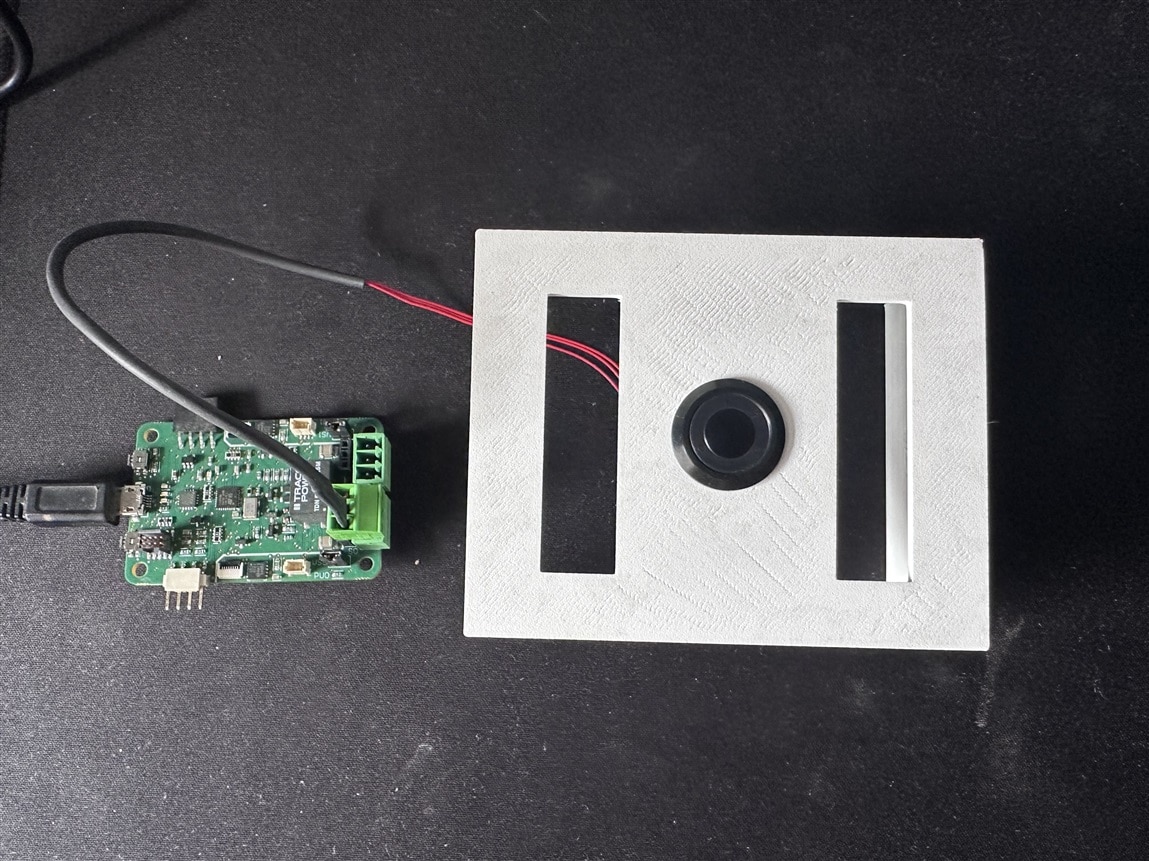

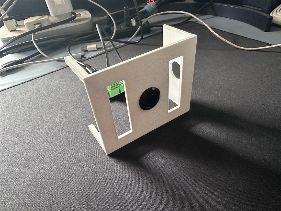

The board was connected to the COM6 port of my PC. To ensure accurate distance measurements, it was essential to keep the sensor stable on a surface. However, I faced some difficulty securing it on the table, so I designed a 3D-printed base to hold the sensor firmly during testing.
The new design allows the sensor to be placed securely on any surface, with its height easily adjustable by altering the orientation of the 3D-printed base.

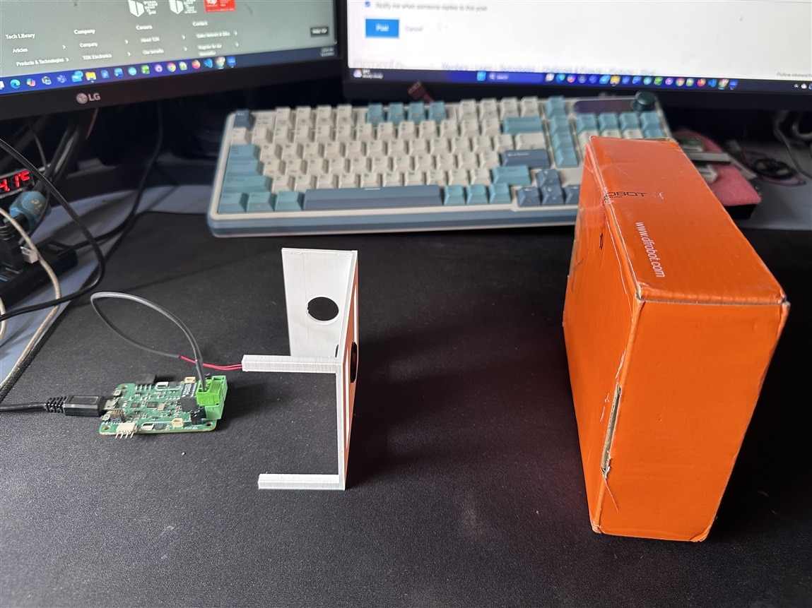

From the distance tab, I was able to easily measure the distance of the obstacle as shown in the above image. I have attached a short video of my distance measurement test.
From my experiment, I observed that the sensor provided stable and consistent readings when the obstacle was placed at a distance greater than 12 cm. For objects positioned closer than this range, the readings became noticeably unstable and fluctuated significantly. On average, I recorded an approximate measurement error of around 2 cm. I was unable to test the sensor at longer distances due to the limited space on my desk; however, this limitation does not significantly affect my project, as the intended measurement range in the water tank is relatively short.
