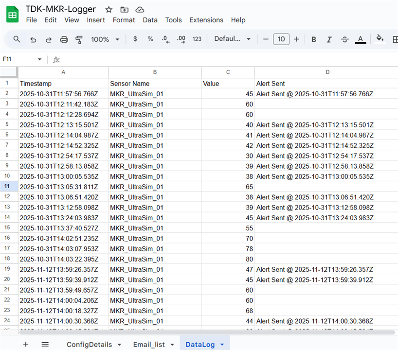

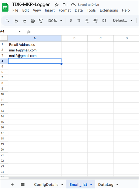

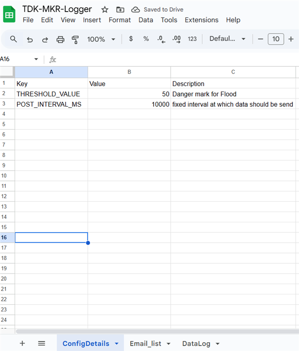

Create a google sheet "TDK-MKR-Logger" with 3 tabs.
tab1 named "ConfigDetails"
Tab 2 "Email_list"
Tab 3 "DataLog"

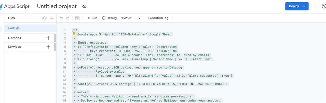

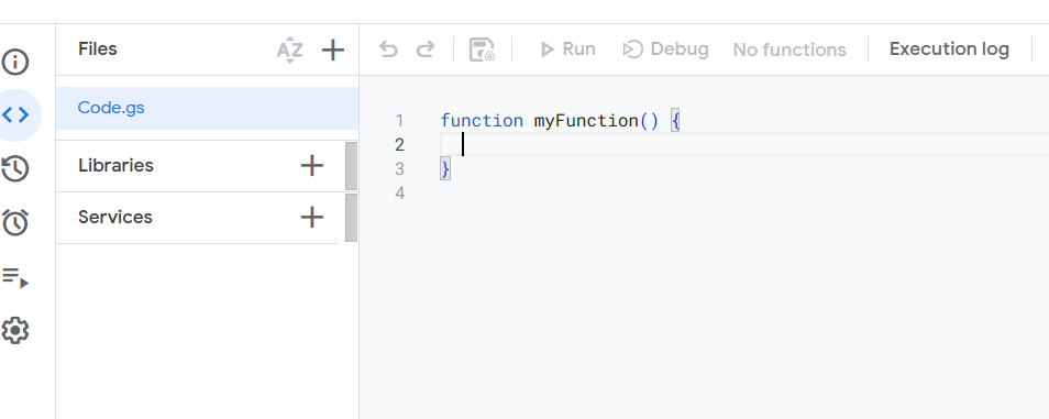

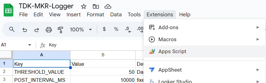

Click on Extensions and select Apps Script
Copy and Paste my Code into it.
 * Google Apps Script for "TDK-MKR-Logger" Google Sheet
 * Sheets expected:
 * 1) "ConfigDetails" - columns: key | Value | Description
 *      - keys expected: THRESHOLD_VALUE, POST_INTERVAL_MS
 * 2) "Email_list"    - column A header "Email Addresses" followed by emails
 * 3) "DataLog"       - columns: Timestamp | Sensor Name | Value | Alert Sent
 * doPost(e): Accepts JSON payload and appends row to DataLog
 *           Payload example:
 *           { "sensor_name": "MKR_UltraSim_01", "value": 12.3, "alert_requested": true }
 * doGet(e): Returns JSON config: { "THRESHOLD_VALUE": 15, "POST_INTERVAL_MS": 10000 }
 * Notes:
 * - This script uses MailApp to send emails (requires permission).
 * - Deploy as Web App and set "Execute as: Me" so MailApp runs under your account.

    const config = readConfig(configSheet);
    const threshold = Number(config.THRESHOLD_VALUE);
    // fallback if config missing or invalid
    const THRESHOLD_VALUE = isFinite(threshold) ? threshold : 15;

    // prepare row: Timestamp | Sensor Name | Value | Alert Sent
    let alertSentText = '';
    const newRow = [ nowIso, sensorName, value, '' ];
    dataSheet.appendRow(newRow);
    const lastRow = dataSheet.getLastRow();
    // If alert requested AND value is below threshold (per your spec "lesser than threshold triggers alert")
    if (alertRequested && value < THRESHOLD_VALUE) {
      // read emails
      const emails = readEmails(emailSheet);
      if (emails.length > 0) {
        const subject = `ALERT: ${sensorName} reading ${value} < ${THRESHOLD_VALUE}`;
        const body = [
          `Sensor: ${sensorName}`,
          `Value: ${value}`,
          `Threshold: ${THRESHOLD_VALUE}`,
          `Timestamp: ${nowIso}`,
          'This alert was generated by the TDK-MKR-Logger Google Apps Script.'
        ].join('\n');
        // send to each email (MailApp.sendEmail handles comma-separated list too)
        try {
          MailApp.sendEmail(emails.join(','), subject, body);
          alertSentText = `Alert Sent @ ${nowIso}`;
          // write alert info into the Alert Sent column (4th column)
          dataSheet.getRange(lastRow, 4).setValue(alertSentText);
        } catch (mailErr) {
          // email failed - log error into sheet in Alert Sent column
          const errText = `Alert FAILED @ ${nowIso} -- ${mailErr.toString()}`;
          dataSheet.getRange(lastRow, 4).setValue(errText);
          // return success with warning about email failure
          return jsonResponse({ status: 'ok', message: 'row appended, email failed', error: mailErr.toString() }, 200);
      } else {
        // no emails found - put note in Alert Sent
        const note = `Alert requested but no email addresses found @ ${nowIso}`;
        dataSheet.getRange(lastRow, 4).setValue(note);
