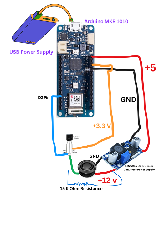

So the fun part begins — wires, boards, and the faint smell of solder.
This is where the project goes from “cool idea” to “actual blinking lights.”
Here in this blog we will discuss the wiring of all components and the Code inside the Arduino Board.

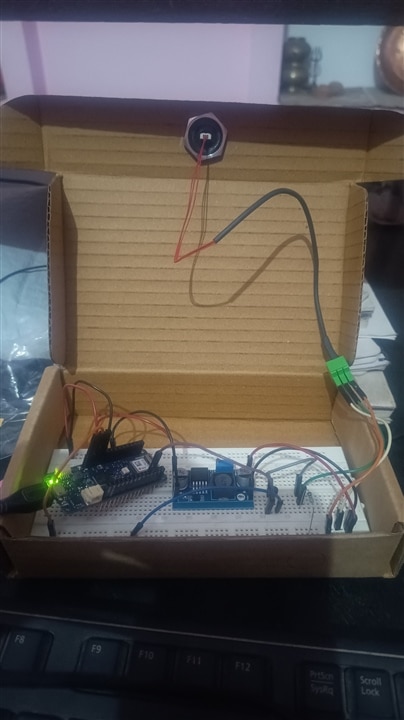

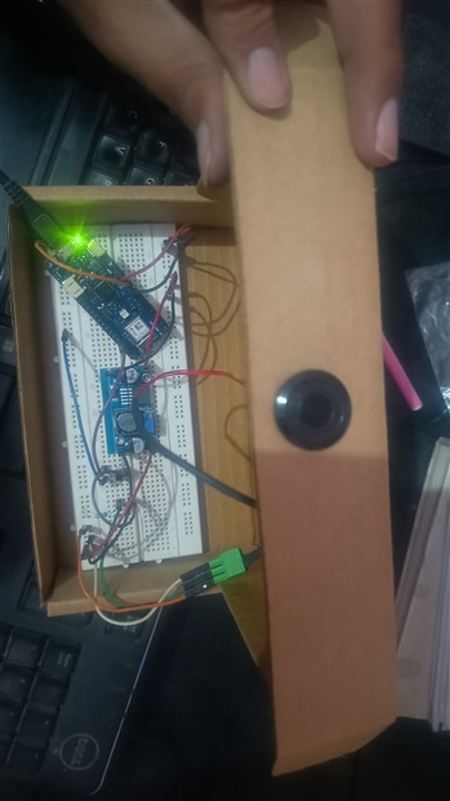

Circuit Arrangement:
Final Circuit
Required Hardware:
  • TDK USSM Distance measurement sendor — the stars of the show.They send ultrasonic pings and measure how long it takes for echoes to come back.
  • Arduino MKR WiFi 1010 — the brain that reads data, processes it, and sends it to the online google sheet for collection anf furture analysis as well as initiate warning email when danger mark is near.
  • BS170 MOSFET , 15 k Ohm Resistance , used for logic level converter to safely operate our arduino
  • LM2596S DC-DC Buck Converter Power Supply to poweup the sensor with 12 v
  • A bunch of colorful jumper wires — because what’s a DIY project without a rainbow of cables?
