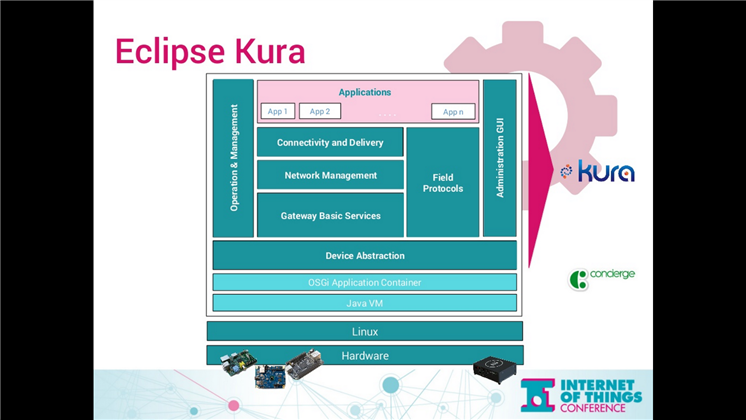

Kura is a Java/OSGi-based framework for IoT gateways you should definitely check out. It basicly has (almost) all the features that I could ask, for remote managment. Has APIs for hardware communication (serial ports, GPS, watchdog, GPIOs, I2C, etc.), management of network configurations, communication with M2M/IoT Integration Platforms, and overall gateway management.

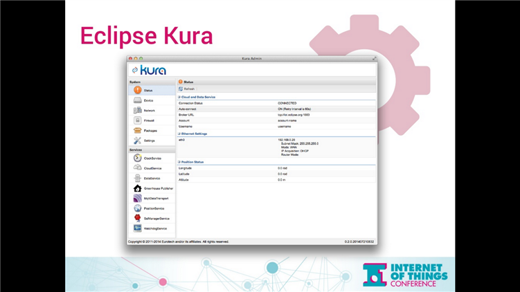

Kura provides a web interface, were you can control your BBB and you can upload you application as an equinox OSGi bundle. So theoretically, if you load all the OSGi bundles of openhab in to it, you will be able to have openhab running within Kura. Not very practical though, so I hope Eclipse Smarthome takes Kura into account, (or vise versa) so we can have best of both worlds :-)

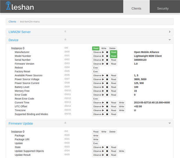

Going a layer lower at CC3200, two very promising eclipse projects which I am sure IoT developers will use in the future (when OTA becomes even more nessesary) are Eclipse Leshan & Wakaama. They are OMA Lightweight M2M (LWM2M) server/client implementations in Java and C.
This is how the Leshan web interface looks like:
So one can have Leshan running on BBB, and wakaama running on CC3200 compiled together with the end application. This provides usefull data of CC3200 to BBB, but more importantly a mechanism for over the air updates, to the CC3200.
Unfortunately, there is no CC3200 port of Wakaama yet, but it should not be that difficult to port, so I guess it’s only a matter of time.
