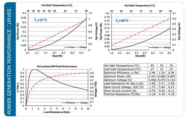

Before proceed, I need a rough estimation of the power requirements of the sensor.
Component
Consumption
Microcontroller
<< 1 mA
Bluetooth module
27 mA
Temperature sensor TMP36
0.5 µA
Humidity sensor HIH4000
0.5 mA
NO2 sensor MiCS 2710
26 mA
CO sensor Figaro TGS 2442
203 mA
Dust sensor
20 mA
The problem comes with the Figaro TGS 2442 CO sensor, that has a very high consumption (203 mA) during the heating cycle. The heating cycle last 14 ms according to the datasheet, so it's better to keep the Peltier cell as small as possible and use a super capacitor to store enough energy to drive the heating cycle.
The power required during the heating cycle is
            P = V * I = 5V * 203 mA = 1.015 W
The energy consumption during the heating cycle is
            E = P * t = 1.015 W * 14 ms = 15 mJ
So I can compute the capacitance of the supercapacitor
            C = (2* E) / (V * V) = (2 * 15 mJ) / (5 V * 5V) = 1.2 mF
So 0.1 F super-capacitor should suffice all the power requirements and provide enough energy during the heating cycle of the sensor
That said, and assuming that not all the sensor will be switched on at the same time, the maximum power requirement will be of about 40 mA @ 3.3V, that is to say 0.132 W
The specifications of the Peltier cell state the following
The Peltier cell with a hot side temperature of 85 °C will provide 341 mW. This value provides a good margin in case the delta T between the hot side and cold side decreases (when, for example, the car is in queue)
    jw0752 over 12 years ago
    Very well written and explained. I will enjoy following your experiment.
  • amgalbu
    amgalbu over 12 years ago in reply to DAB
    Thank you very much...
    not sure about the size of the Peltier cell because I never  had designed with that.
    Luckily, there a bigger cells out there I can take into account in case my analysis was wrong
    DAB over 12 years ago
    Nice analysis of your current and thermal needs.
