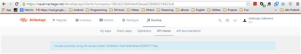

For development, the easiest approach is to use the access token that can be read on the AirVantage portal.
For a real-world application, probably the most user-friendly approach is to define a username and a password in a configuration file. This is the approach I will use later to create OpenHAB binding. The URL to authenticate using a username-password pair, is as follow

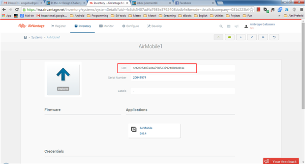

systemUid is the unique identifier of the system to query. The Uid can be read on the portal
