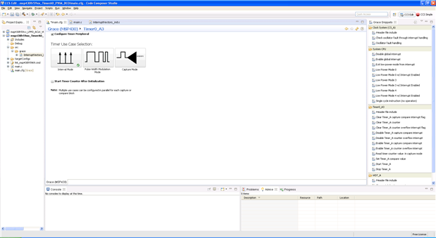

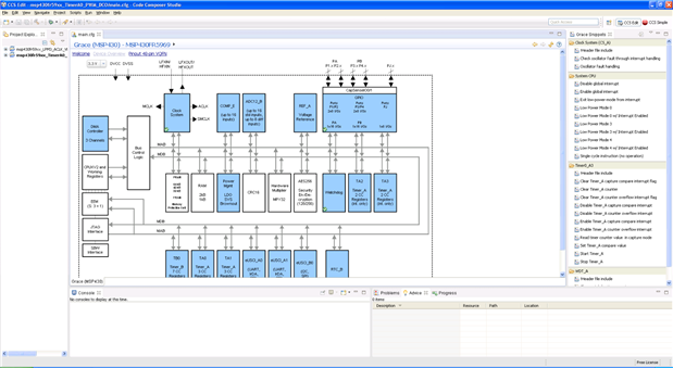

Texas Instruments provides a great graphical tool integrated into its Code Composer Studio IDE for configuring MCU peripherals: Grace.
Using Grace is very easy: just click on the sub system you want to configure..
.. and this will lead you to a form where peripheral settings can be easily changed
In the same way we can configure Timer 0 to generate an interrupt every second
and GPIOs
