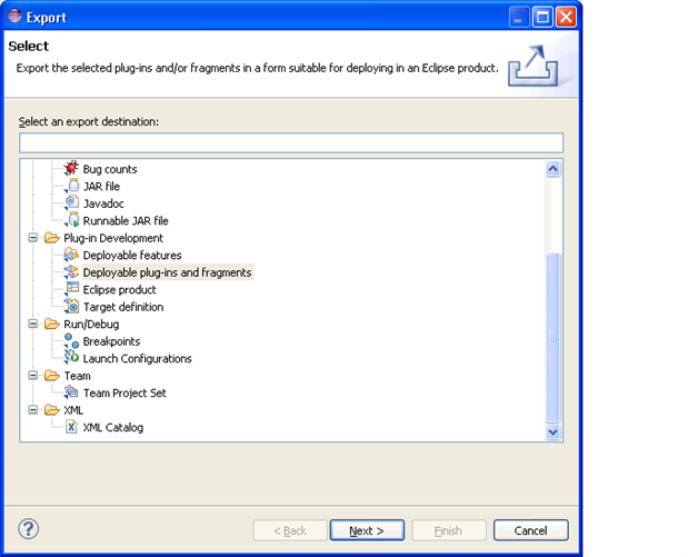

The binding bundles developed (namely gpio and iarvantage) needs to be copied to the openhab/addons folder. To create the bundle, right click on the project and select Export. In the Export wizard, select Deployable  plugins and fragments.

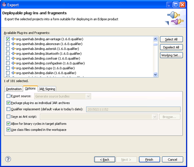

In the next step, enter the folder where you want the plugin to be generated and check the options as shown
During the deployment, I experienced a Java ClassNotFoundException. I was not able to completely understand the reason for that exception, and the only way to solve this issue was to create a bundle for each jar the AirVantage binding depends on (okhttp, Gson, scribe and org.json). I created bundle projects by selecting File -> New -> Project -> Bundle and following the wizard steps
Finally, I added the bundles to the Import-Package section of manifest file of the AirVantage binding.
