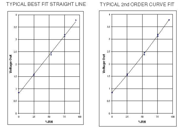

The output voltage varies linearly with the Relative Humidity. Output voltage depends on Relative Humidity as shown in picture
According to datasheet, output voltage ranges from 0.8 V to 4 V. Because ADCs are configured to have a Vref of 2.0 V, a voltage divider is required.
