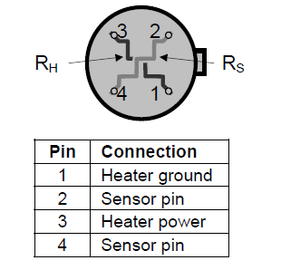

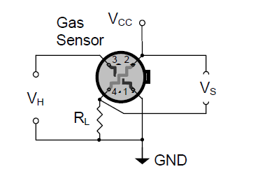

MiCS 2710 has four connections:
A heather power of 43 mW is applied between pins 3 and 1. This the temperature of the sensing resistor to reach up to 220 °C. Detection of pollution gases is achieved by measuring the voltage drop on the sensing resistor Rs.

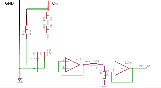

The wiring diagram is shown below
The sensor is powered with 5 V.

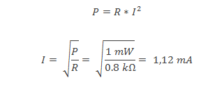

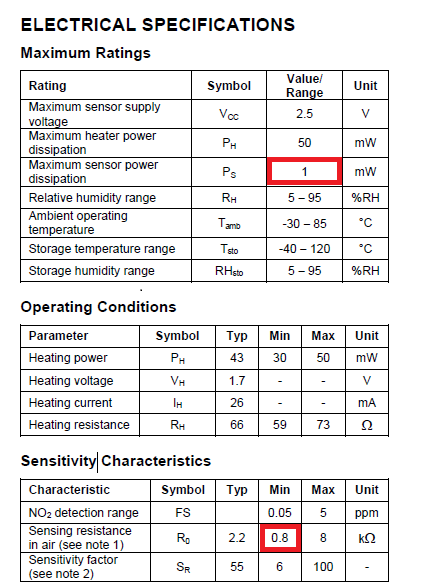

Datasheet states that the maximum power the sensor can dissipate is 1 mW.
Because in the worst case Rs is 0.8 kΩ, the maximum allowed current is
To limit the current that goes through Rs, another resistor is required. The value of this resistor can be determined by imposing
Let's take some safety margin and let's use a 4.7 kΩ resistor.

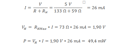

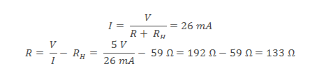

To determine the resistor to connect to the heather terminal, we have to impose that the current through the heather is 26 mA. So
With a 100 Ω resistor and a 33 Ω resistor in series, we also meet the maximum power dissipation requirement, because
I have now to limit the maximum voltage not to exceed to analog Vref (2.0 V). The voltage limits are
The Vmax exceeds the ADC limit, so a voltage divider is required. The ratio of the voltage divider is
I can choose R1 = 10 kΩ and R2 = 0,73 R1 = 7,3 kΩ. The voltage divider are going to be connected in parallel with the Rs, so it would affect the Equivalent Resistance. An operation amplifier in buffer configuration is required.
