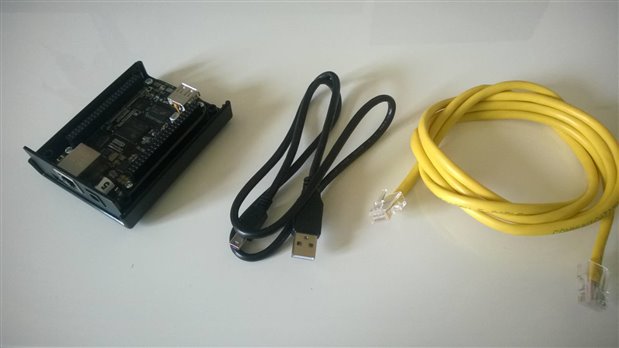

Ingredients (still feeling festive)
To start off, we will need
1    BeagleBoneBlack
1    Ethernet Cable
1    USB mini cable or 5V power supply
IP Scanner (i.e. Advance IP Scanner)
Telnet/SSH Client (i.e. PuTTY, SmarTTY, OSX Terminal)
Web Browser (i.e. Internet Explorer, Chrome, Firefox, Safari, etc.)
Directions

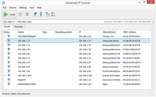

  4. Run Advance IP Scanner, to retrieve the IP address of the BBB.  Sort by Manufacturer and take note of the device from Texas Instruments.  This will be the IP Address of the BeagleBoneBlack.

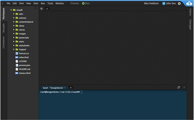

   8.  Back to the web browser, connect to the Cloud9 IDE at port 3000, i.e. 192.168.1.77:3000
   Cloud9 IDE is yet another great feature, you can delve into development immediately without installing a separate IDE.

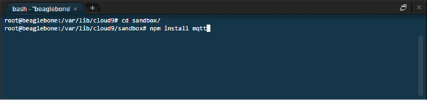

   9. In the Workspace (right pane), create a new folder for development.  In the bash pane (lower section), change the directory to the newly created folder and install the MQTT library.
   10.  After that's installed, you can proceed with the Beagle Bone specific guide.
