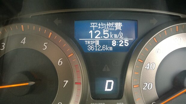

Alternatively, but still using the vehicle information, this time labelled as L/100km, or the amount of fuel used (in Litters) per 100kms.  My car has this rating specified to be approximately 3.8L/100km or 26.3157 km per Litter of petrol used.  These values are mostly likely measured in controlled conditions and does not reflect the car's actual efficiency.  In reality, the efficiency is just 12.5 km/l as shown in my dashboard.
This link has a scientific method to calculate the theoretical value of how much CO2 is emitted during combustion arriving at 2.22 kg of CO2 per liter of Petrol.  By using actual vehicle efficiency of 12.5km/l and 2.22 kg of CO2 per liter of Petrol, we can resolve how much CO2 per distance travelled (in km), and call this as the CO2 emission factor:
CO2 Emission Factor = 2.22 kg/l ÷ 12.5 km/l = 0.1776 kg of CO2 per kilomter or 177.6 gram/km.
