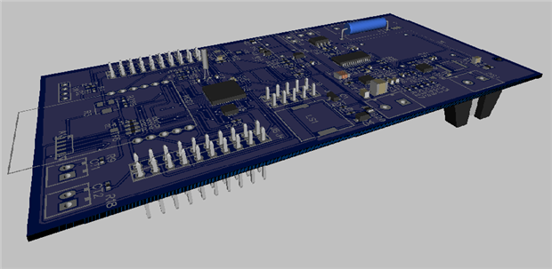

I kept the schematics and moved on to design a booster pack instead that would fit both (CC3200 and MSP430FR45969) Launchpads.  Everything is going quite on track until I realised that there aren't enough available IO's on the MSP430FR5969-EXP board.  Another revision of the design was inevitable, and this time, I have to incorporate an MSP430FR5969 chipset into the booster pack design.  And that's how the board came about.
Board Sections

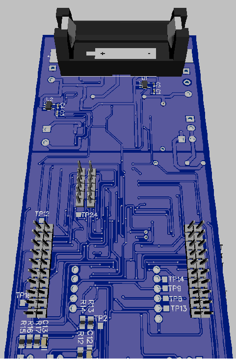

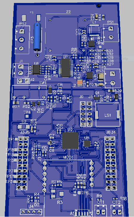

Below are renders of the Top (image on the left) and Bottom (image on the right) assembly.  I did not bother on the missing 3D models, the render should be enough to explain the different sections and main components of the board.

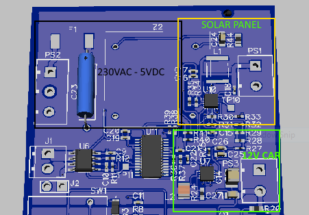

The top section is where the power supply(s) are laid.  See below.
Battery is placed in the bottom assembly.
The idea here is to only populate the section relevant to the sensor node.  Thus saving a bit on PCB manufacturing costs.
U3 in the center of the lower part of the board is the MSP430FR5969, which will be populated for the emission sensor node.
MOD1 is placeholder for the Bluetooth Smart (nRF8001) module.
