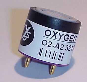

In order to make the system work, the first thing we need are sensor. I did some search and this is what I came up with. I need to fit sensors, parts and possibly some smd equipment into budget and that has made me fiddle with the design a LOT! Truthfully I am a bit ruffled up at this stage as to how I am going to make this work. People already have big workstations and workshops and I have been intimidated by all the "extra-electronic" craftsmanship in the past. I will do my best but it is easy to get scared at this point. image
Sensor research
So there are two types of sensors which can fit into budget. Here is a brief of both.
Semiconductor sensors
These are relatively inexpensive compared to other sensing technologies,  robust, lightweight, long lasting and benefit from high material sensitivity and quick response times. They have been used extensively to measure and monitor trace amounts of environmentally important gases such as carbon monoxide and nitrogen dioxide. They are also sometimes called Metal oxide semiconductor gas sensors. These are relatively cheaper and good example is the MQ-x series which is popularly available. I am not sure about the advantages or disadvantages and hence I request anyone with the knowledge to contribute.
Electrochemical Sensors
According to wiki, "Electrochemical gas sensors are gas detectors that measure the concentration of a target gas by oxidizing or reducing the target gas at an electrode and measuring the resulting current." The gas diffuses into the sensor, through the back of the porous membrane to the working electrode where it is oxidized or reduced. This electrochemical reaction results in an electric current that passes through the external circuit. In addition to measuring, amplifying and performing other signal processing functions, the external circuit maintains the voltage across the sensor between the working and counter electrodes for a two electrode sensor or between the working and reference electrodes for a three electrode cell. At the counter electrode an equal and opposite reaction occurs, such that if the working electrode is an oxidation, then the counter electrode is a reduction.

Sensor Selection
I am selecting the following sensors for my application:
Gas DetectedTypeSensor Model
Carbon MonoxideSemiconductor Sensor
MQ307A or ME2B-CO(INSIDE)
MQ-7,(OUTSIDE)
MQ309A or TGS3870( CO and Methane)(OUTSIDE)
Carbon DioxideSemiconductor SensorMQ135(OUTSIDE)
Carbon DioxideElectrolchemical SensorMG811(INSIDE)
Hydrogen SulphideSemiconductor Sensor
MQ136(INSIDE)
HydrogenSulphide and Air QualitySemiconductor typeMQ135(OUTSIDE)
OxygenElectrochemical SensorME3-O2(INSIDE)
OxygenGalvanic Cell TypeKE-25(OUTSIDE)
Ozone and Nitrous OxideSemiconductor TypeMQ131(OUTSIDE)
Nitrous OxideElectrochemical TypeME3-NO2(INSIDE)
HydrogenSemiconductor TypeMQ137
Volatile HydrocarbonsMOS TypeTGS2602
Temperature & HumiditySemiconductorHDC1000(INSIDE)
Temperature & HumiditySemiconductorHDC`1000(OUTSIDE), TMP008
Particulate Matter-No IDEA
I am still working on the Particulate Matter part of the Sensors. I hope these fit in budget. The system this time will have an extensive array of data on various gasses in the air which will be logger to sierra airvantage.
Help
I request anyone with knowledge to correct, ammend, remove, remake the above list. Please share your experience because I have none in this particular field.

  • michaelwylie
    michaelwylie over 11 years ago +2
    I almost forgot, don't forget to check the cross-sensitivity of other gases to the sensors you find. For example, you have a Hydrogen Sulfide sensor which responds to NH4 and CO. Also, keep in mind your…
  • michaelwylie
    michaelwylie over 11 years ago +1
    A lot of these sensors will be good for building a detector, that is to alarm when a certain threshold is reached, since drift is always a problem in those semiconductor sensors. Note in the technical…
    DAB over 11 years ago +1
    You might want to consider setting up a big funnel attached to a flexible hose with a small fan at the sensor end. You would be able to pull in a larger volume air sample and concentrate the material detection…

    mcb1 over 11 years ago
    Don't let the whole application overwhelm you.
    While keeping with the design, try to break it into chunks and not rely on one piece of hardware making another work.
    You have a number of sensors, and each measures its own gas, so each is a standalone and will give some results.
    Sure the whole spectrum will give a better picture, but so would a lot of other things  ... all pointing to its bad.
    Is it possible to have two sensors, one filtered and one not to show the difference.? (maybe cost ???)
    Don't worry about workshops and lots of tools.
    I saw a very nice plasma cutter and a 3D printer used very effectively, but it didn't mean it couldn't be done in other ways.
    mcb1 over 11 years ago in reply to ravi_butani
    have no way to battery powered application
    That depends on the battery size and your solar panel.
    You could also add a small wind vane to help.
    If you are solar powering this part of the system, how often or how long do you need to do the reading.?
    It also seems to me that you are trying to show the impact of an event, so you must be able to do the readings either side and during the event.
    if it's blowing then maybe upstream will give the readings without the impact.
    The difference is what will show the impact.
  • ravi_butani
    ravi_butani over 11 years ago in reply to michaelwylie
    Completely agree... I like to add one more point... Reading stabilization time after power up sensor if too much (12-15 mins I have tested MQ-2) for MQ series gas sensor... By combining Power requirement and time to get stable reading MQ series sensor have no way to battery powered application...
