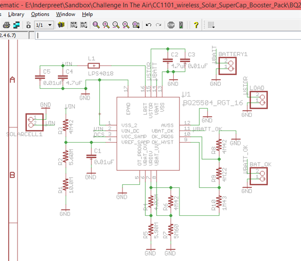

Since we have a 50USD budget for the PCBs I started work on the circuits. Not having selected the sensors still meant that I can work with power circuit. For the charger, I am using the BQ25504 so I used eagle to make the schematic.

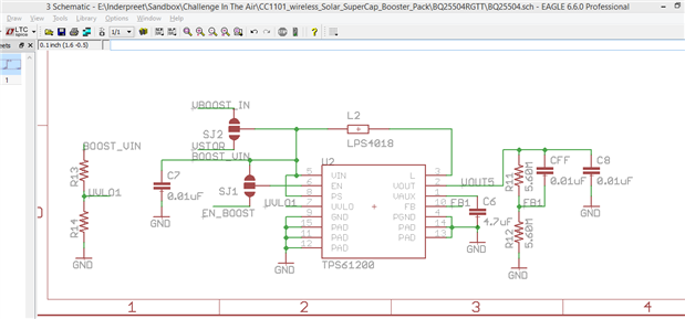

Had to jump through a few hoops to make the footprint and that thing is smaller than small. Next was the boost converter for the 5V. This is getting to be very similar to the Fuel Booster Pack but it has its differences. The boost converter selected is  the TPS61200. Again a few hoops and I made the footprints to match the devices.

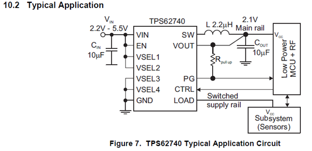

Next is the buck converter which is the tps62740. The footprint of this one is still a bit fuzzy and if anyone has it please send it across.
As of this writing, that part is under construction and I will blog about it in the next post.
